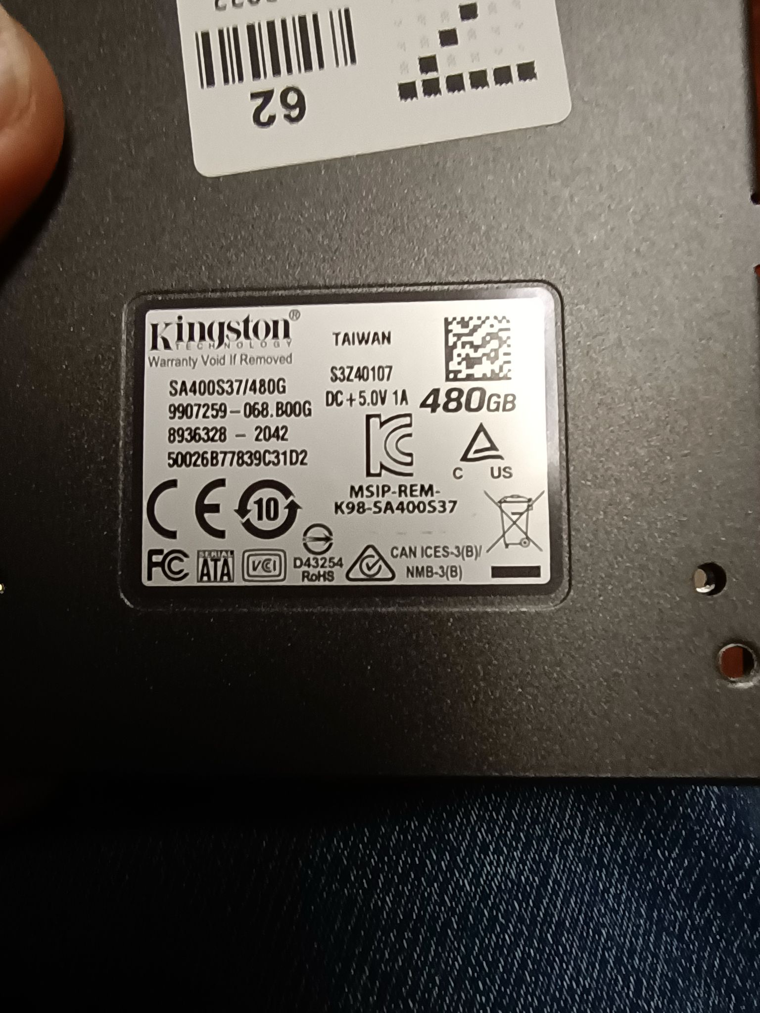

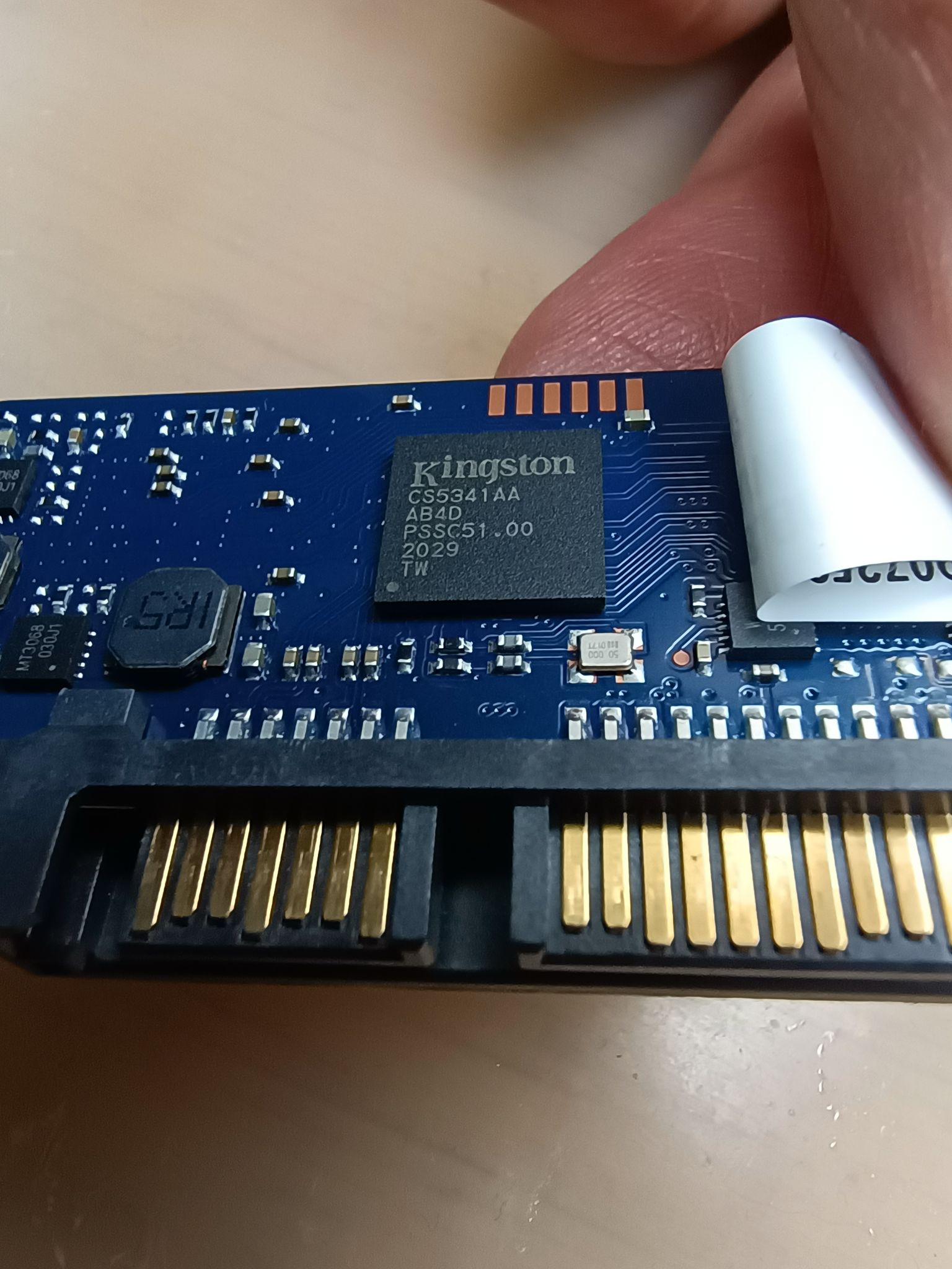

I have disk Kingston SA400S37 480GB with atypical controller Kingston CS5341AA. Is this controller Kingston CS5341AA is rebrand another supported by PC3000 controller?
I attached picture this drive.
Marcin
Re: Kingston SA400S37/480G - controller Kingston CS5341AA
Postby Roman_TS » 05.12.22, 10:29
CS4341AA is SM2258XT, so CS5341AA most likely SM2259XT. Short the drive in SAFE MODE and check the passport ID. It will show you what's there.
Postby Roman_TS » 06.12.22, 12:07
Yes, it's SM2259XT. Try different loaders frm the list, probably you will find one compatible.
Postby gameboybin » 14.08.25, 19:10
igen wrote:Hi Roman,
I have an SSD (1TB) on the SM2259XT controller with four HYNIX memory chips (ID: AD 89 28 43 00 B0) with the 3dv6-128L TLC 16k signature.
Is there a loader for this type?
Thank You for answer.
Have you been able to patch the drive??? i am having the same Hynix memory chip
Vendor.................................. : Hynix
Type.................................... : 3dv6-128L TLC 8k
Postby Roman_TS » 15.08.25, 19:31
Hello everyone.
Kingston drives based on SM2259XT are NOT supported, because they have different modification of internal Firmware.
