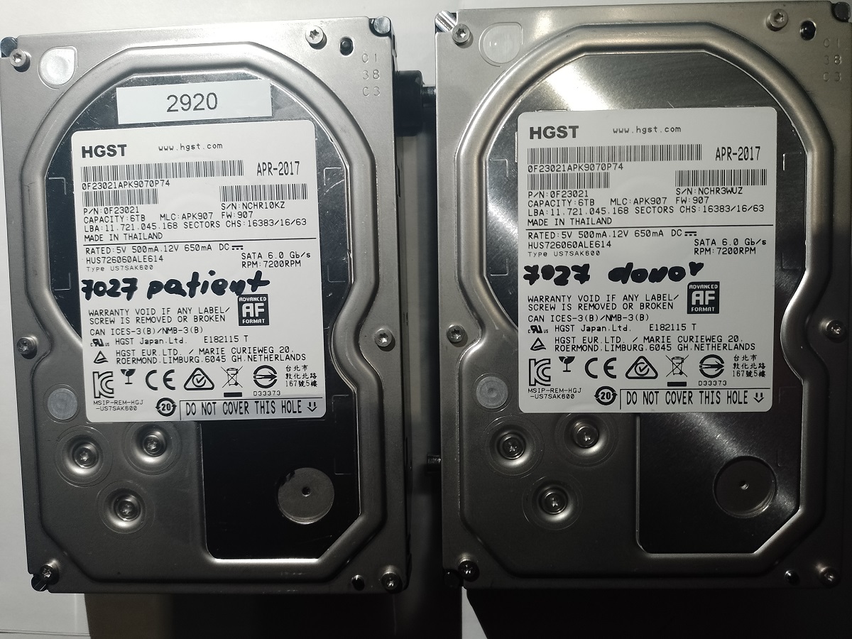

Photo of the front of the patient and donor below (patient and donor - front.jpg).
patient and donor - front.jpg (376.19 KiB) Viewed 10573 times

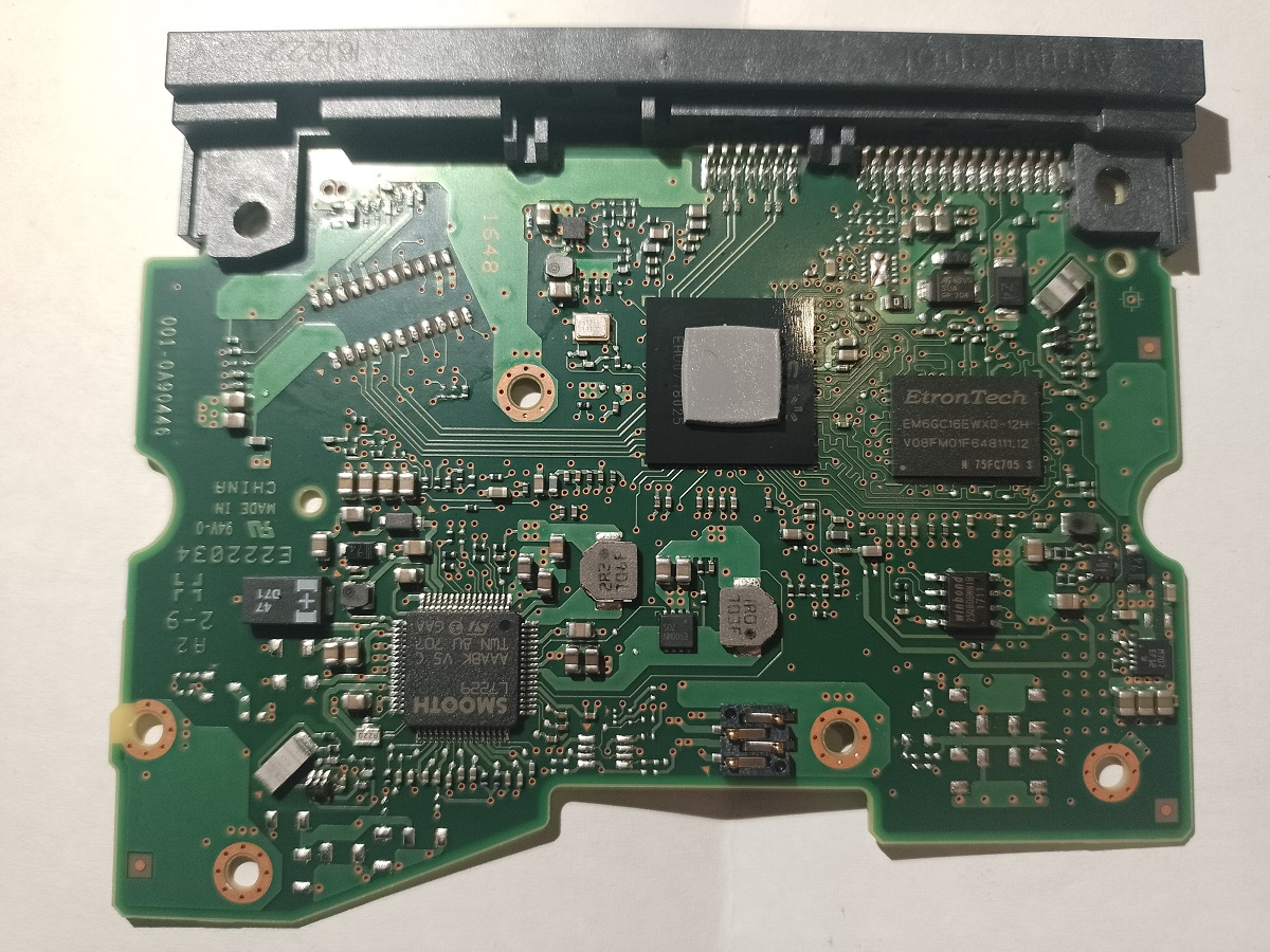

Photo of the back (PCB) of the patient and donor below (patient and donor - PCB's.jpg).
patient and donor - PCB's.jpg (427.36 KiB) Viewed 10573 times

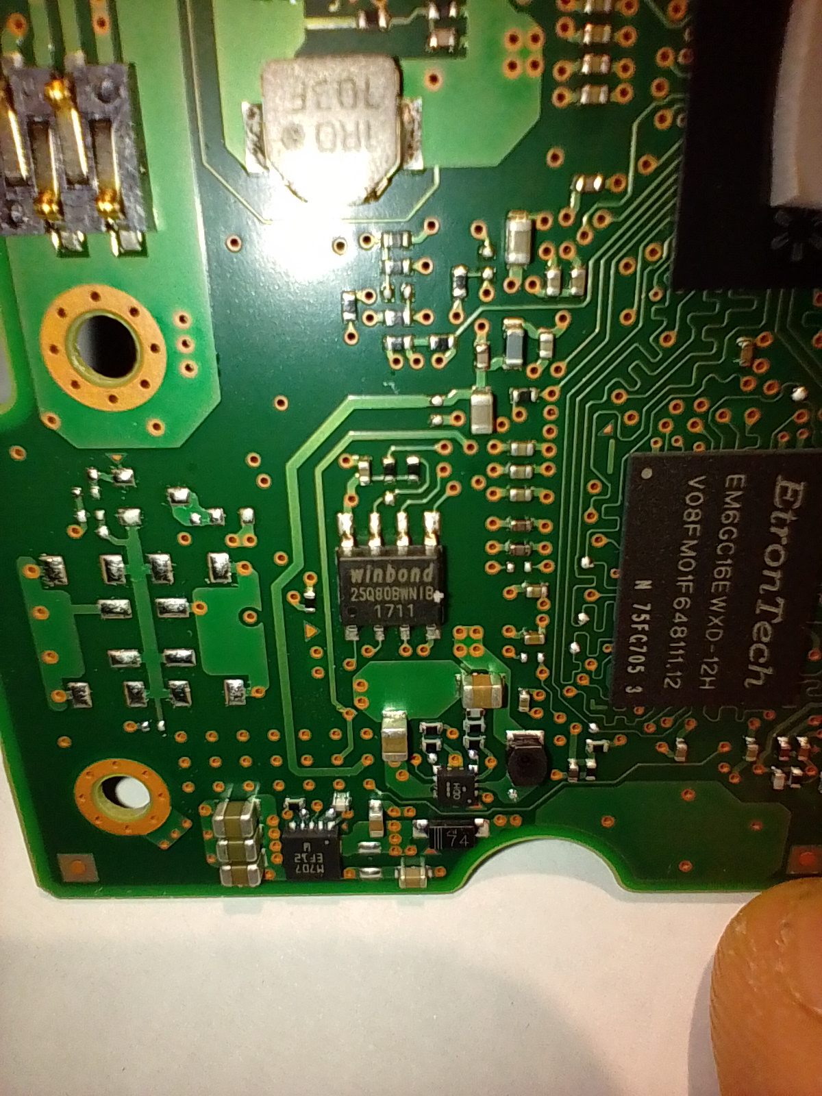

PCB photo:
Probably ROM chip (1 MB):

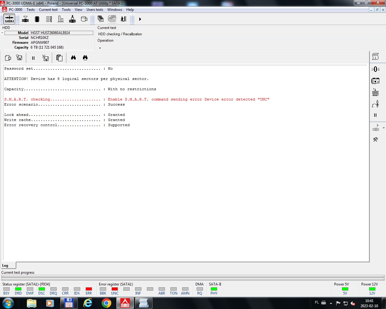

Also when running in Universal Utility there are differences:
To illustrate, i show the start of a healthy disk (donor) in Universal Utils:
Donor - Universal AT Utility message - immediately after turning on.jpg (209.05 KiB) Viewed 10573 times

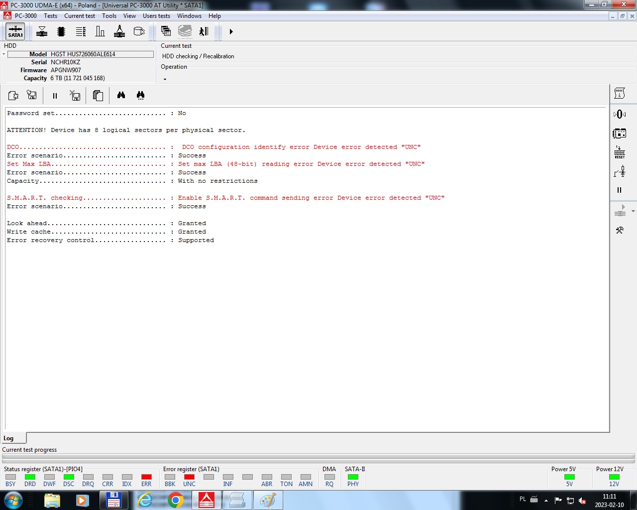

And - for compare - this is, what it looks like when trying to start Universal Utility patient disc - after powering up and trying to start right away:
Patient - Universal AT Utility message - immediately after turning on.jpg (223.99 KiB) Viewed 10573 times

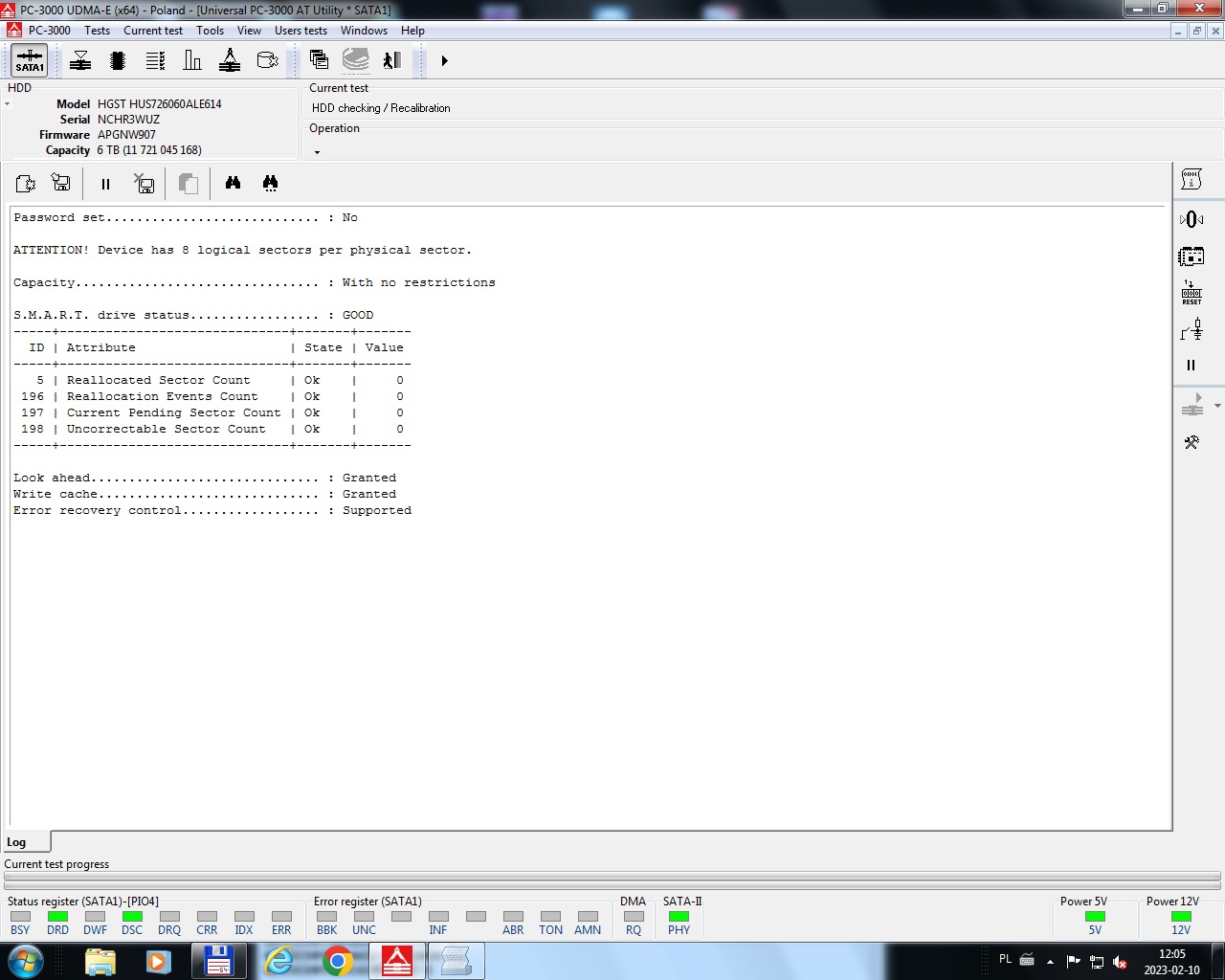

As a curiosity - i will mention the fact - that the "patient" disk after starting (for several dozen minutes - every few - several seconds) something "cracking"...
As if it was trying to read something ... After this time (several tens of minutes) - these sounds is stop and when i try to enter the Universal Utils - shows messages with fewer errors:
Patient - Universal AT Utility message - 0.5 h after turning on.jpg (193.43 KiB) Viewed 10573 times
