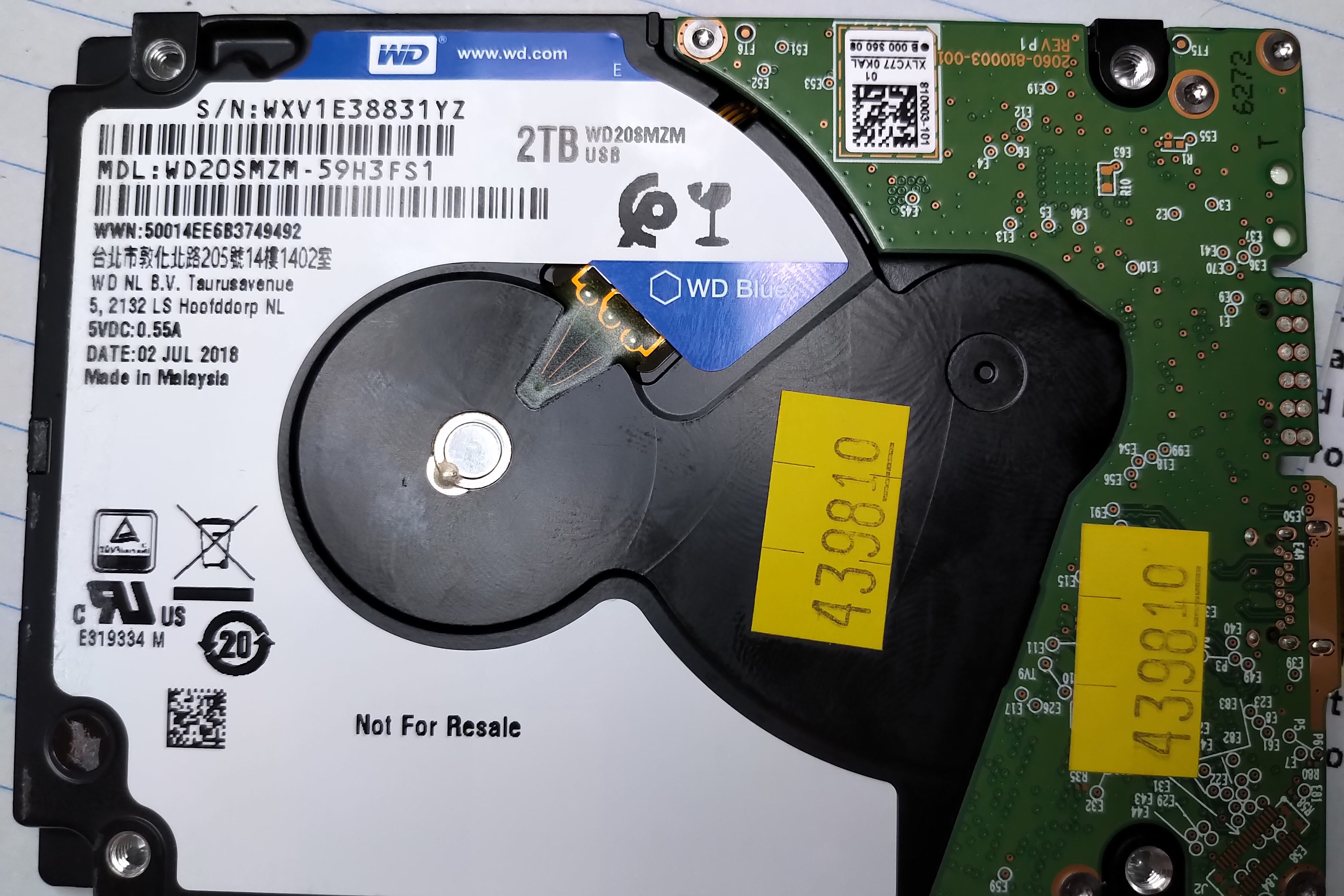

Any suggestions for this drive?
Model: wd20smzm-59h3fs1
USB C PCB: 2060-810003-001

lcoughey, we didn't see such drives here in support.. Have you tried to solder SATA adapter to see if the drive allows to read SA?
