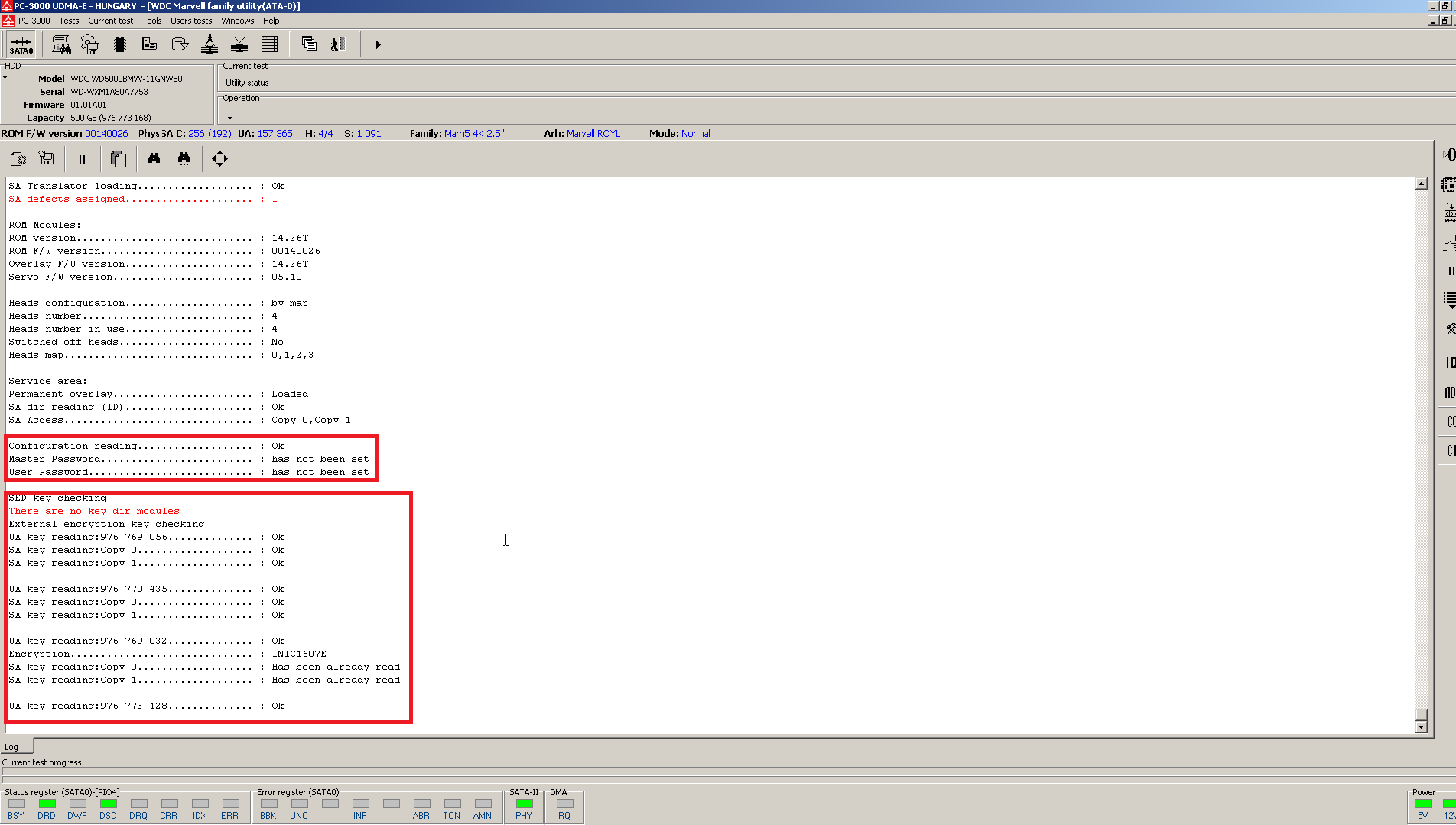

I write here because I got some problem with a WD external drive. It is a WD MyPassport external drive. I open the hdd case and it is a WD5000BMVV-11GNWS0 drive. The costumer said it was worked correctly, after he shut down his pc, in the next start, he didn't see anything in his HDD.
Drive doesn't clicking, it is spining and look like everything is OK. PC3k can detect it and get correct ID, I try read it via USB and also with compatible sata board (original 701675 USB & 771672 Sata) but the results are the same. Can acces SA, rom, moduls and tracks also.
The main problem is that the drive is a SED drive. The whole drive is encrypted via the usb controller (INIC-1607E-C11). I try decrypt it with DE and utility also, but it shows this is an user password.(Costumer said he is never set any type of password, and the drive not show in the init procces. each password shown as "has not been set") I found a topic in the forum where someone from the Ace staff wrote that, this is a bug on PC3k now, this was an older topic, I hope there is some solution this problem. I try some similar PCB with same model but nothing happen. I would try to read it without PC3k under windows, but it recognized with different capacity. For example with the original PCB it shows 51TB, swapped with similar USB pcb, 2,3TB. Hardware modul checking shows modul 04 & 05 has problem with error code: "07-Module state reading error". I rewrite it from DB, from SA image but the problem still unsolved. I was thinking maybe it is a ROM issue, I generate one from SA, but it is exectly the same.

No. Costumer said he never set password, he never use password to this hdd. If user password setted the utility recognize it. It is a SED drive, the problem is with the decryption.As is know wd utility can clear user password. I try it but got error.

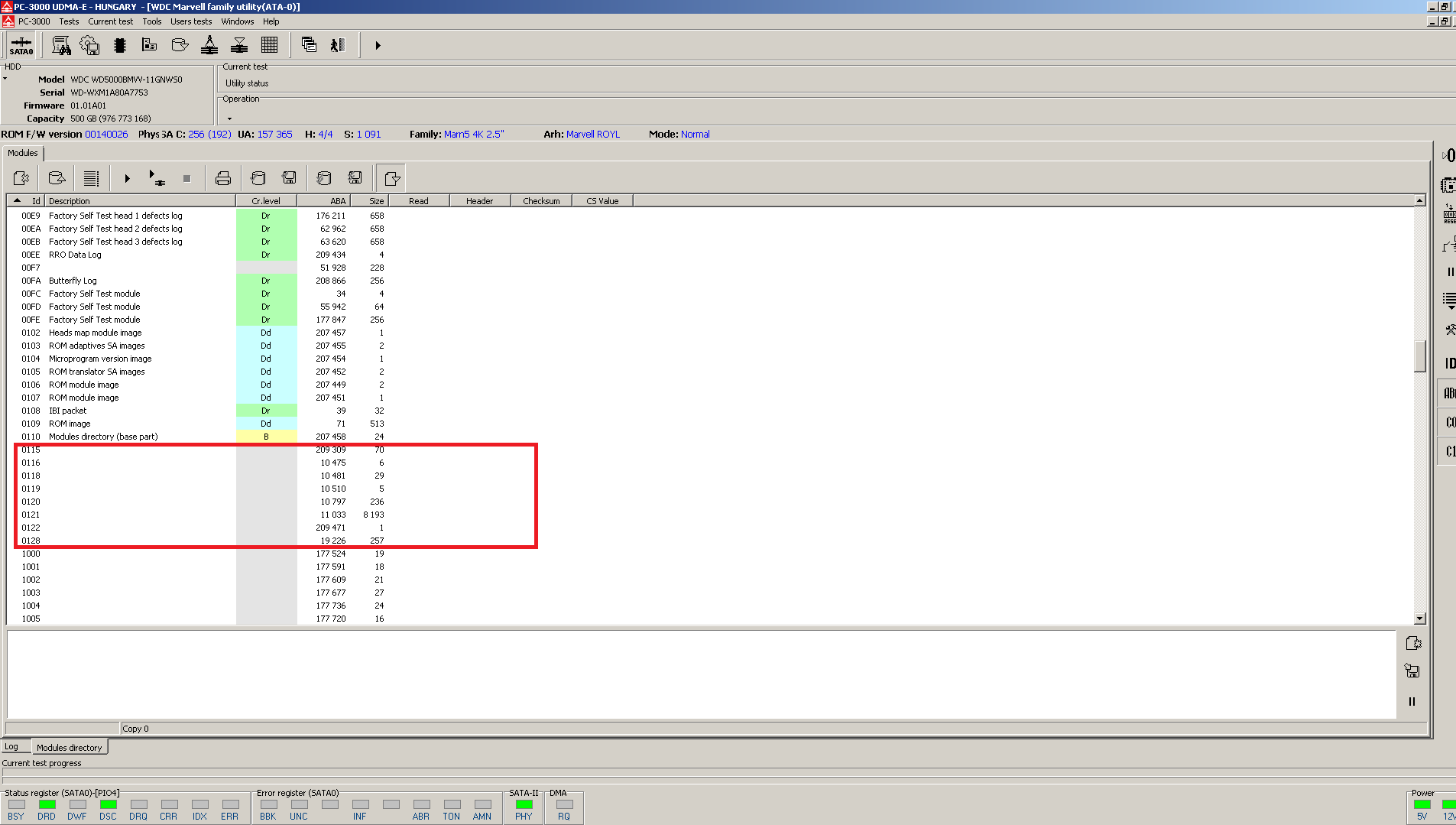

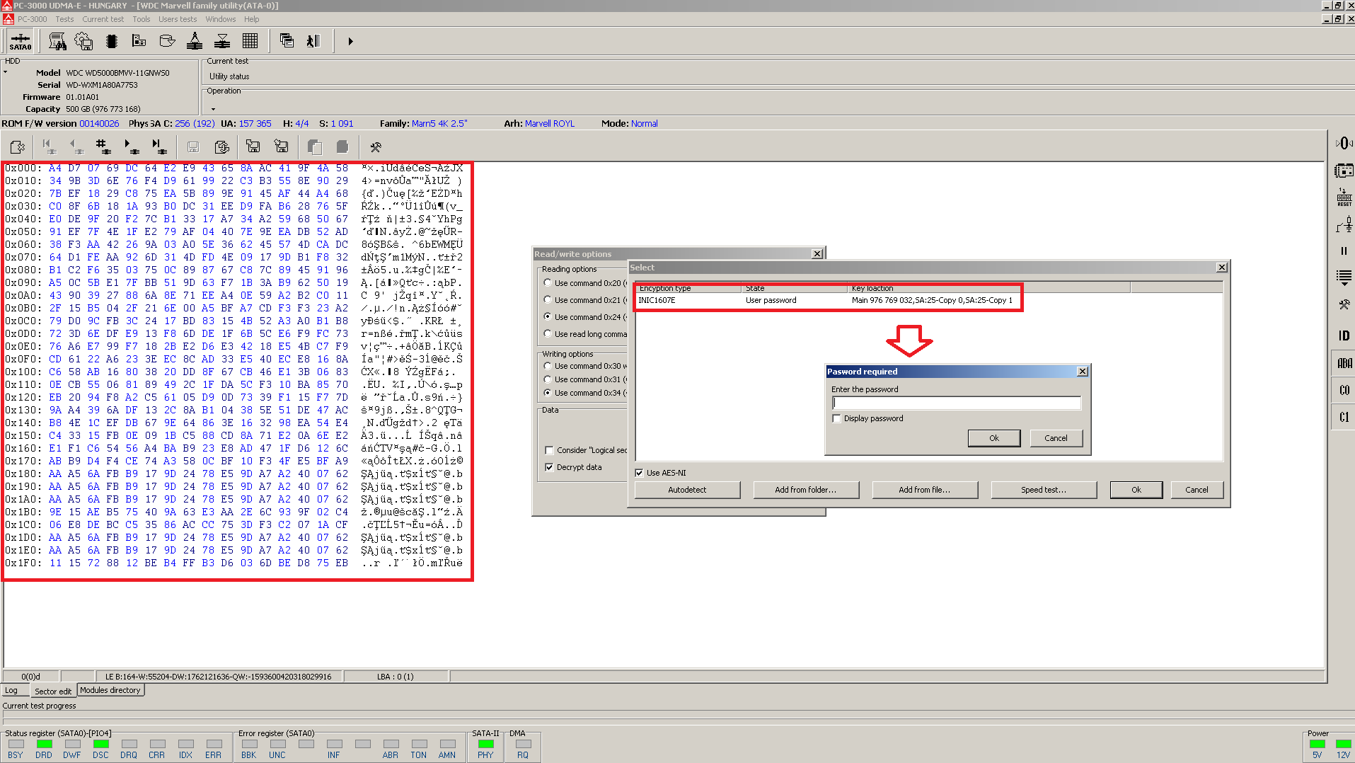

Thanks for your answer. As is wrote, there isn't any user password setted. Module 0127 doesn't exist on my HDD. I can enter utility and make backup just couldn't decrypt the sed. I attached a picture from my drive. Now it has sata board, but the utility shows the same with original USB board.
sector editor
Picture from modul dir.
Picture from utility

protontech, thank you. INIC1607E is a common issue when the drive asks for decryption password the customer has never set. Unfortunately it has no solution for now. I don't know any software or any person which could solve that.
