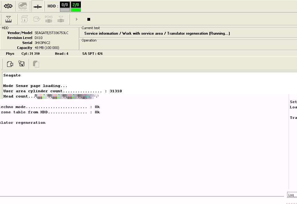

Dears,
I run the command "Translator", but how show in the picture 2, the result show error.
Alexandre Silveira
This HDD recognizes with the capacity 48MB.
Show error command "Translator"

What i do
1 Translator regenration
when it comes back
2 HPAto max ( Service area)
3 regenerate translators
Vikas

I have one Seagate SCSI 146GB hard drive with medium errors.... i tried my best to regenerate translator but no luck at all ... i did try the method written by VIKAS ... but it did not help at all ... it was a easy fix before. ? i can read all the modules OK.. when power up gives me p list errors .. it is not reading plist... utility gives option to upload plist .. can i trick the drives by uploading plist of other drive and regenerate the translators ... any help appreciated
Filipp_TS
Joined: 15.04.13
Reputation: 9 / (93)
Re: HD Seagate 36GB SCSI, error command Translator Regeneration
Postby Filipp_TS » 18.02.16, 16:43
Nadpc3k wrote:Source of the post can i trick the drives by uploading plist of other drive and regenerate the translators ... any help appreciated
P-list module is unique list of defects and can't be taken from the donor drive/profile folder.
That's why the translator regeneration procedure doesn't fix the problem..
