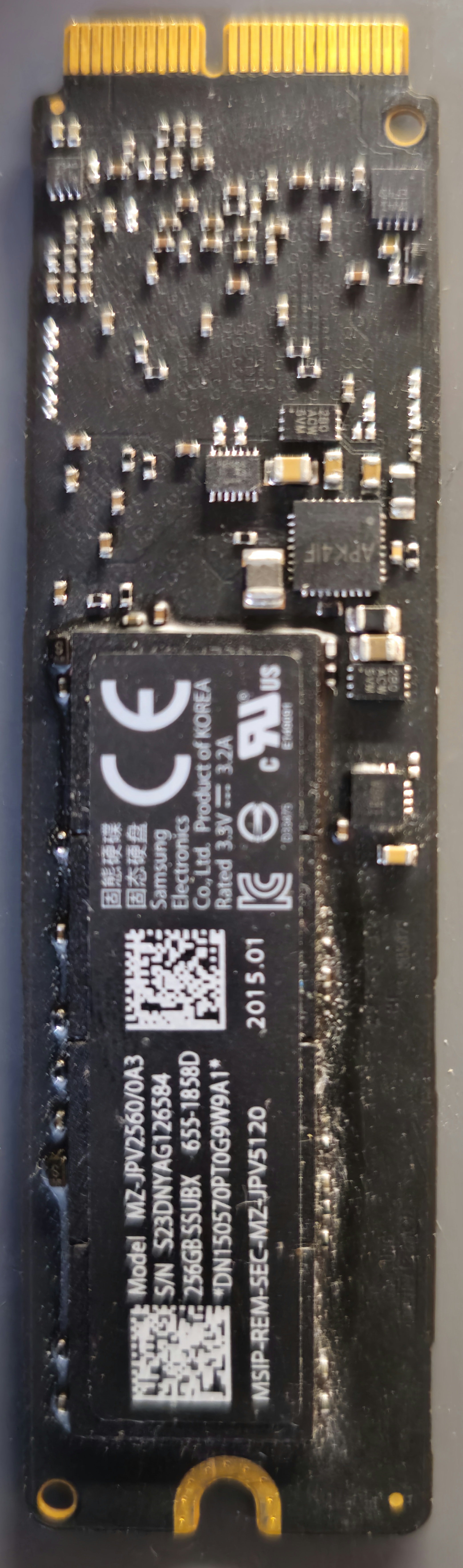

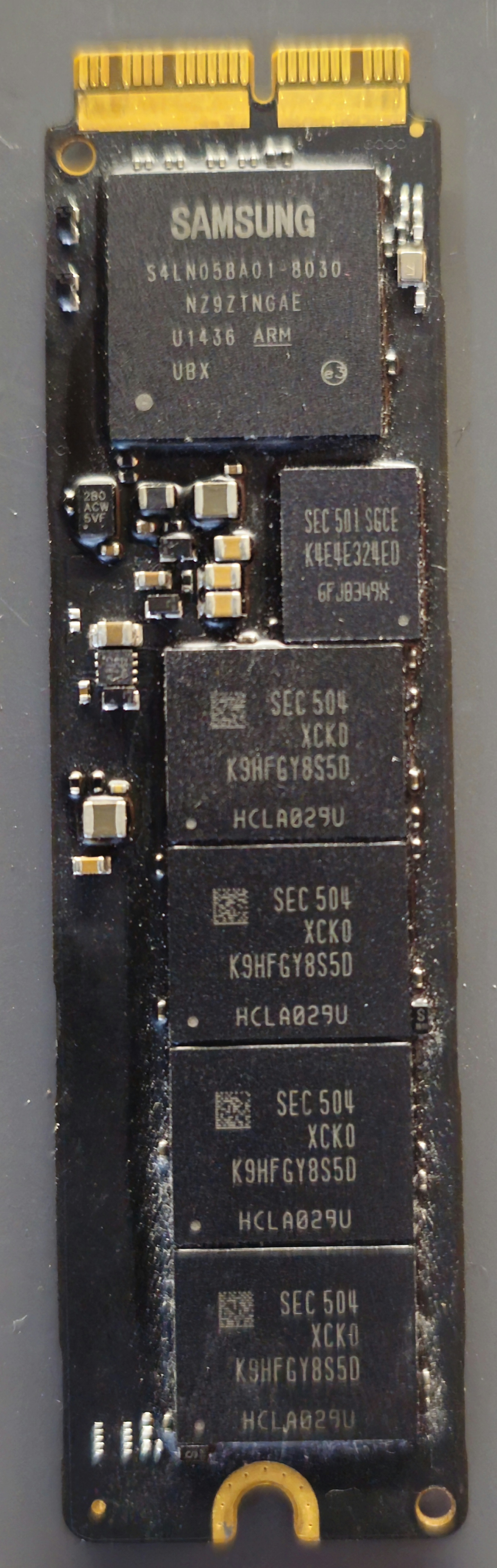

Hi. I got this SSD from Apple device. There was a little bit liquid on it. i cleaned everything under the microscope.
i plugged it in the apple adapter and the adapter in the portable iii. got DE SSD extended
by power on i get 0,47A and green DRD DSC PHY, no red light appears
the same values i got with the same but healthy ssd
choosing universal utility and universal ssd ssd utility (SATA) it goes during initialysation in BSY, no red lights (DRD DSC and PHY green, utility can not initialize, after the warning box running utility I press yes and of course no ID can be read
Power 5V all time is 0,47A (with the healthy SSD the utility is initializing and 5V Power switches down to 0,17A)
I thought the safe mode could help here, but dont know where to short on the SSD mainboard?
256GB SSD S4LN058A01 controller

I have the same modell of ssd that is working good. is it worth to replace the nands in the same order from the patient to the donor? can this help?

In your case the main problem is inside the internal firmware. Translator is damaged, as the result, drive goes into BSY as soon as you are trying to read anything from it.
NAND swap will not help here. Problem is inside NAND, not in CPU or PCB...
