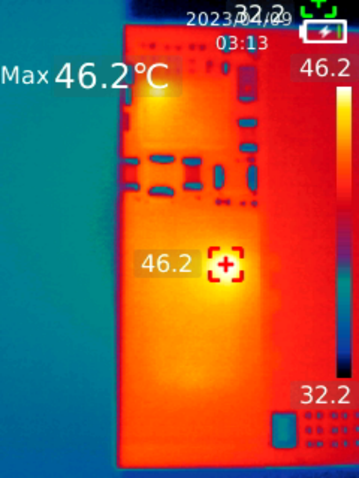

i have WD Blue SN570 NVMe SSD WDS100T3B0C - SSD - 1 TB looks dead and i tested under thermal cam and found there are 2 spot which got hot. are those spot normal to get hot
i attached the spots' photo
any one can help ?
thanks in advance
Spots which got hot.jpg (468.12 KiB) Viewed 10816 times

Postby Roman_TS » 05.07.23, 22:49
Usually this model of WD Blue has a problem with capacitors and resistors near the M.2 interface. I recommend you to resloder them.

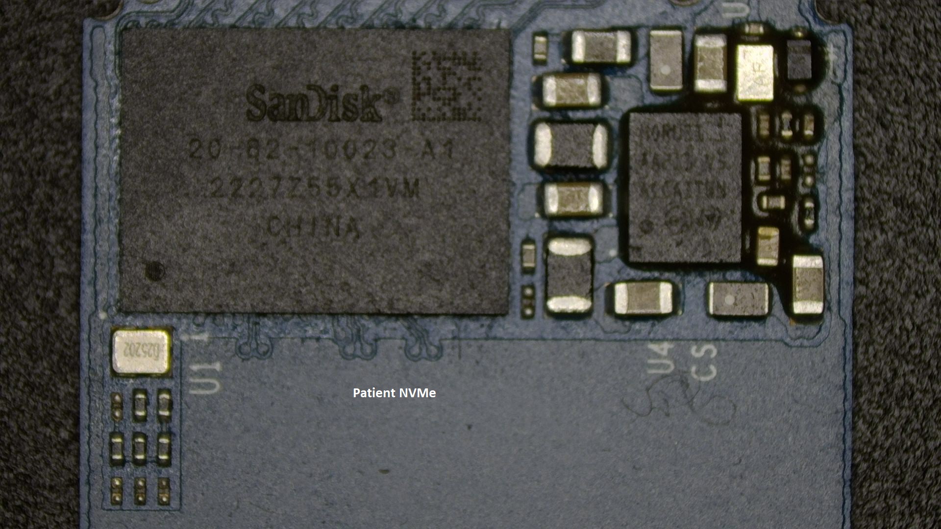

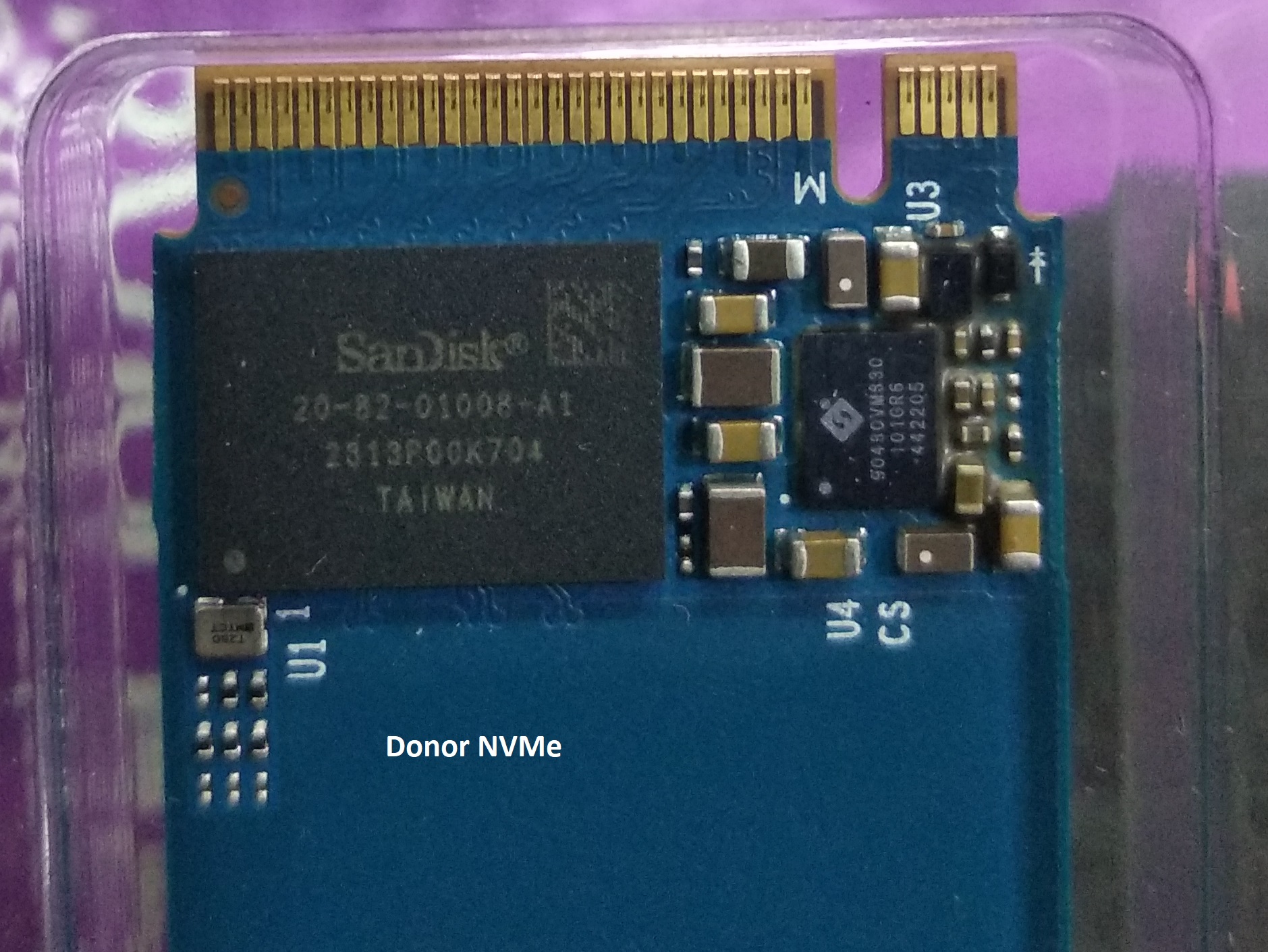

Dear Roman, i found this the same NVMe but not the same Controller no. is it possible to be a perfect for NAND Swap ?
i attached the 2 controllers' photos
Re: WD Blue SN570 NVMe SSD WDS100T3B0C - SSD - 1 TB
Postby Roman_TS » 06.07.23, 23:17
I'm afraid that it could be incompatible modification of CPU. I recommend you to find exactly the same model with the same CPU name.
