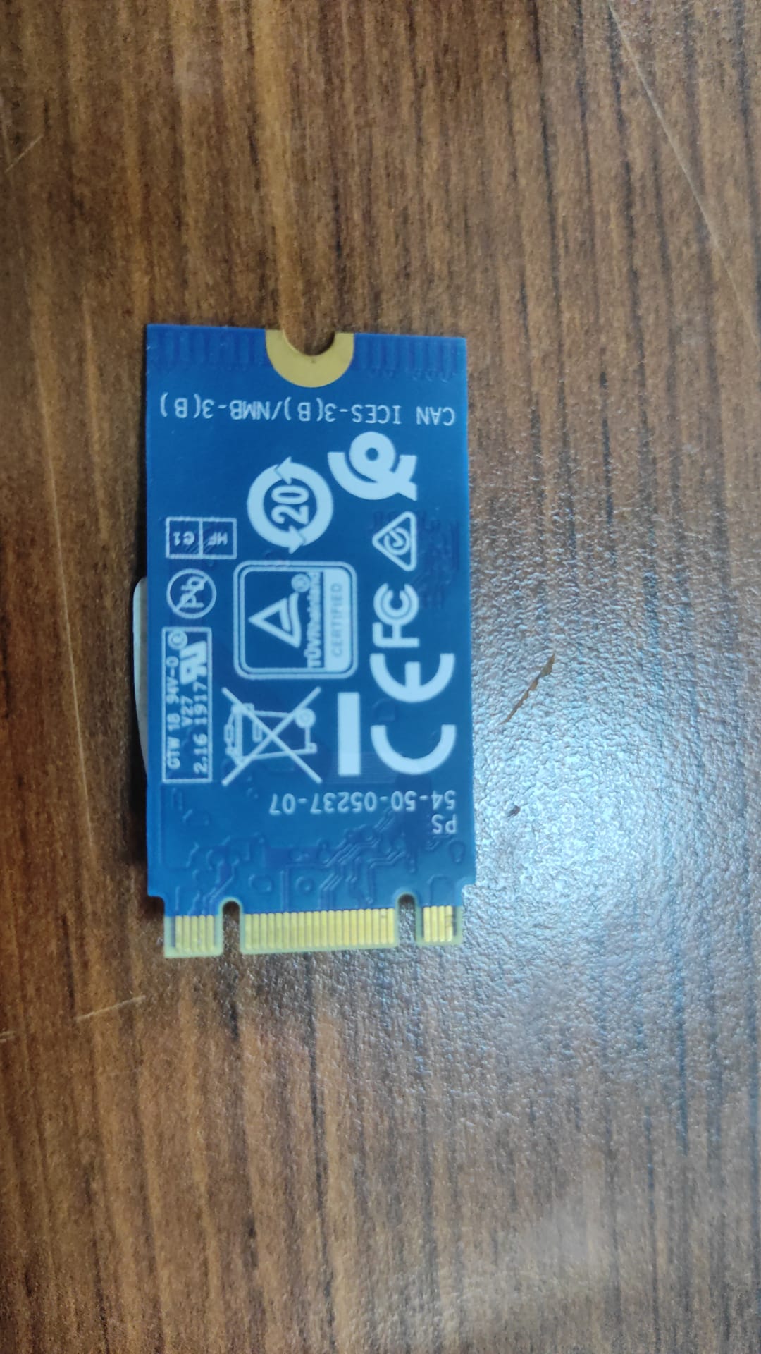

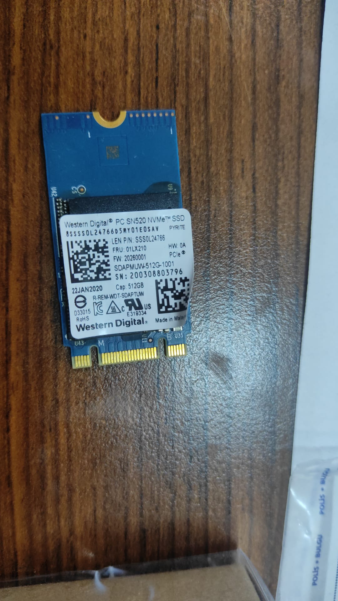

Hi, I have an nvme with 20-82-007010 controller. Busy stays too. Is a solution possible with pc3000?
Re: 20-82-007010 wd nvme
Postby Roman_TS » 05.07.23, 20:09
Could you post a picture of your drive PCB?

Postby bayerecep » 12.07.23, 13:17
pictures added

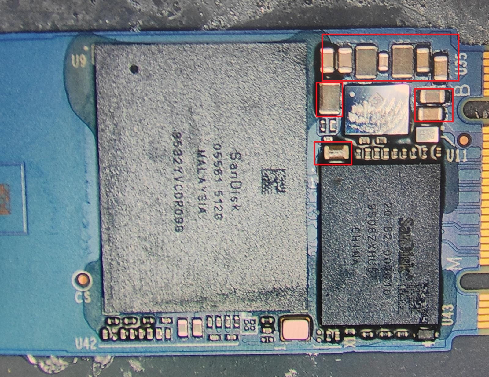

Try to check these capacitors/resistors. Their failure is one of the most popular issues on these WD models.
