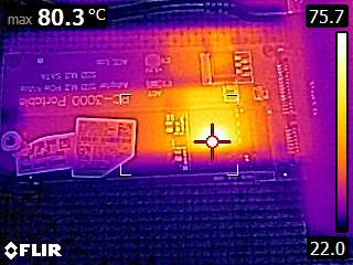

Probably some shorts, the HDD absorb 0.68 ampere, and the hot spot is located on the nand.
Would be interesting to understand if it is 100% nand issue of it can depends from some component demaged.

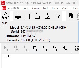

IDs correctly:
Hot spot and 0.69 ampere:
MZVLQ512HBLU-00BH1 IDs but no access to secotrs
