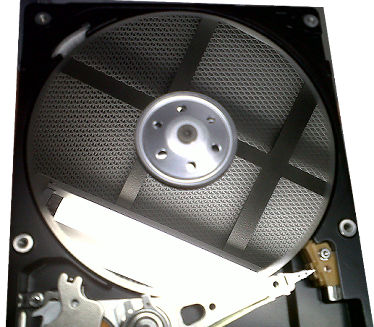

Thanks Databalance. I opened the drive in a cleanroom. One head is broked. and if you see in the attached picture there is a ring in the edge of the platter. Do you know if the heads replacement may works even that ring in the platter? Or the new heads will damage because of that? I have a donor in house, so I like to try if somebody have any experience with this situation.

Re: HDP725016GLA380 HEAD SWAPP EASY?
Posted: 11.01.12, 15:53
by a.morales
Here is the photo
See the ring on the platter edge
Posted: 11.01.12, 17:14
by dmarques
The picture doesn't have very good quality, but if that in outer diameter is a ring, it's a huge one.
You don't have much chances really, as I even think SA is located there.
