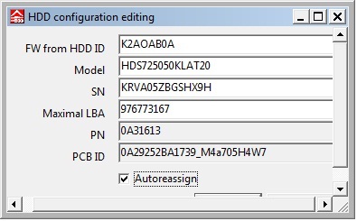

In the meantime i have changed the MHA in cleanroom.
Now the drive is spinningup, but dont display the Model or SN.
Not nocking. I start the utility by selecting model mauel and resources from profile.
In HDD configuration and editing tool, Model and SN are correct..
