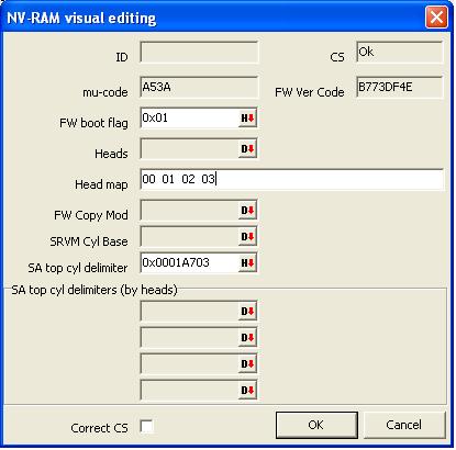

1. Edit head map in nvram
Current head map is 00 01 02 03
nvram original.JPG (26.15 KiB) Viewed 27284 times

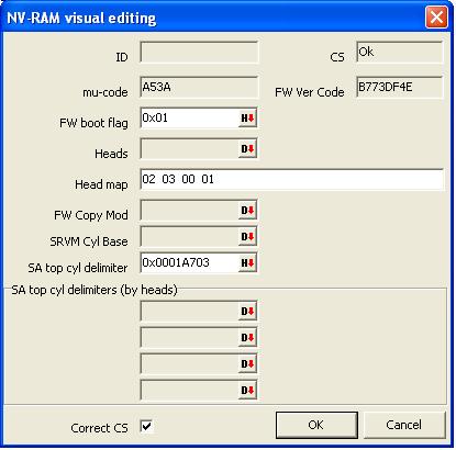

We should change heads by pairs, so we set 02 03 00 01
nvram corrected.JPG (26.22 KiB) Viewed 27284 times
And correct checksum
Press ok.

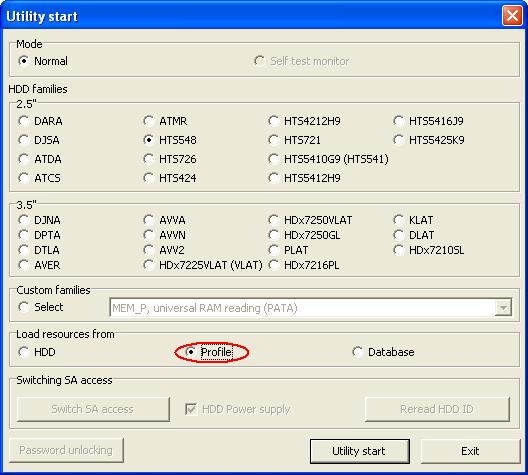

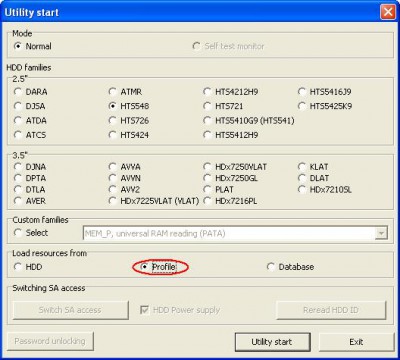

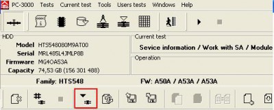

Restart utility and load resources from Profile
utility start.JPG (46.1 KiB) Viewed 27284 times

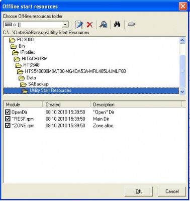

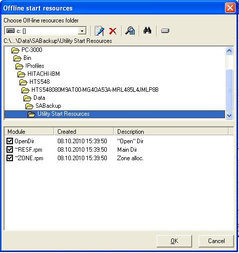

Then select modules that have been saved before
offline start.JPG (36.5 KiB) Viewed 27124 times

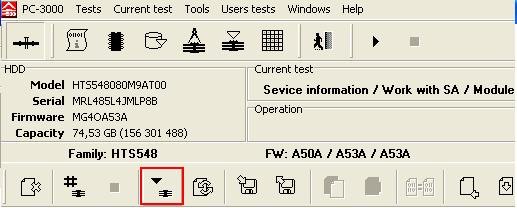

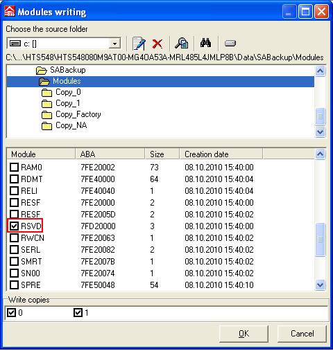

Then go to menu WORK WITH SA - MODULES WRITING
And select saved modules
At first we should write marker of SA - RSVD module
modules writing.JPG (49.81 KiB) Viewed 27284 times
Then restart the power and write the rest of modules

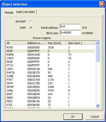

So, select
TOOLS - UTILITY EXTENSIONS - SERVICE INFORMATION OBJECTS
Click on RAM/NV-RAM tab and check RAM
Set initial address 0x0
Block size 0x40000
And press OK
object selection.JPG (38.87 KiB) Viewed 27124 times

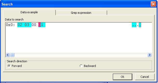

Now we have to find head map in RAM

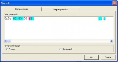

Press CTRL+F and type data example 02 03 00 01 (current head map)
Press OK

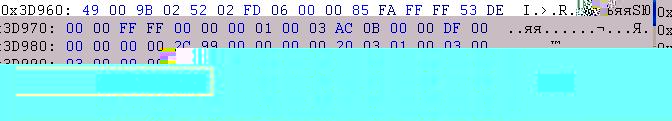

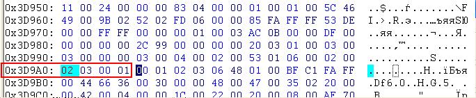

We will find head map by address 0x3D610 in NV-RAM image and by address 0x3D9A0
head map 1.JPG (41.38 KiB) Viewed 27284 times

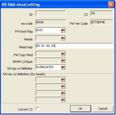

We have to change head map by address 0x3D9A0 (in case if we work with 3.5" Hitachi IBM, we should change head map in image of nv-ram (0x3D610))
head map 2.JPG (18.86 KiB) Viewed 27284 times
