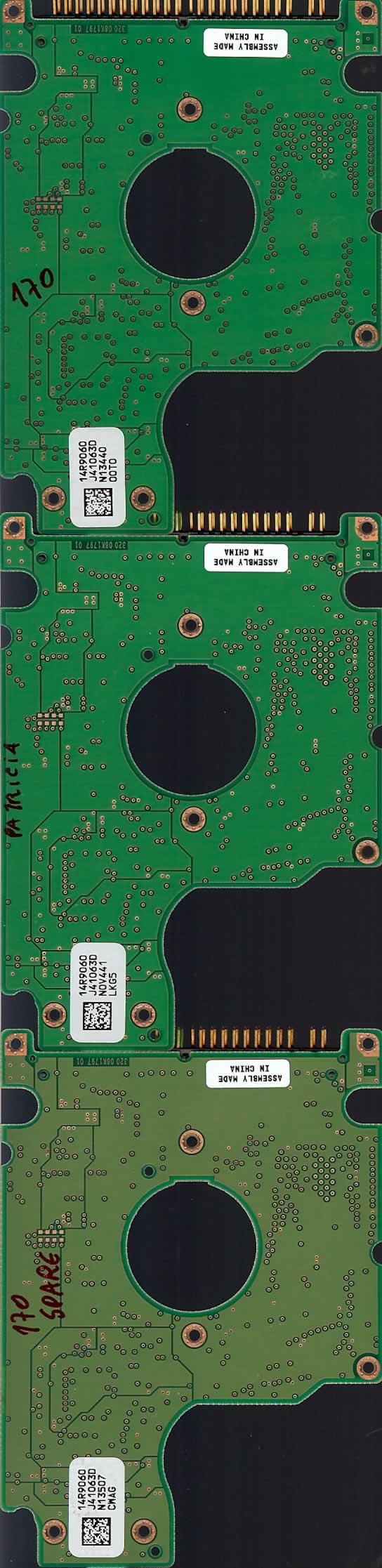

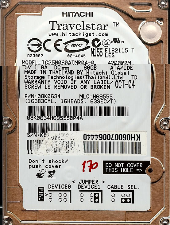

I Have a ATMR disk that when i connect the disk to UDMA it gives BSY.
I try to connect in safemode but i could not also get ready.
So i find two matchs from PCB the first two lines.
When i change the PCB i could get Ready State but not detect the disk.
As you can see the PCB mact the first two lines.
Also Somes chip´s match in the PCB
SAMSUNG 425 - K4S641632h-TC75
AGERE MS552 - this also match
So i remove to NVRAM from the patient PCB and put it in other PCB and read it
But the nvram was corrupet no data there.
I save for that NV-RAM the version off AD0A, AD4A, AD5A, but the same problem the drive can not get ID.
What can i do Here, the utility can not read the NVRAM from the SA for this model ?

Dear ZeBong,
For PCB Swap should be the same ROM chips on donor drive and patient drive.
Can't see them on photo, but are they the same?
