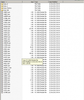

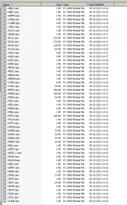

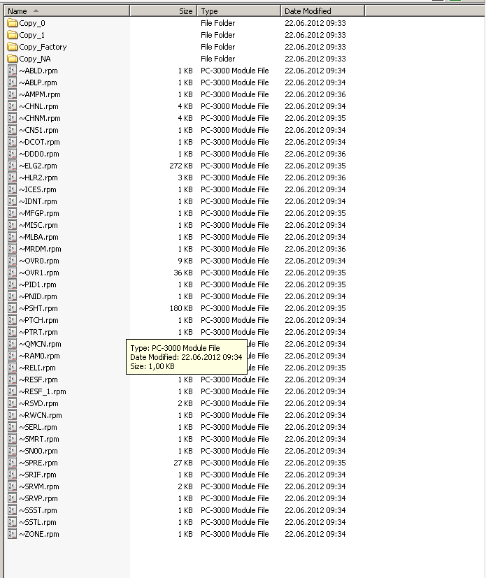

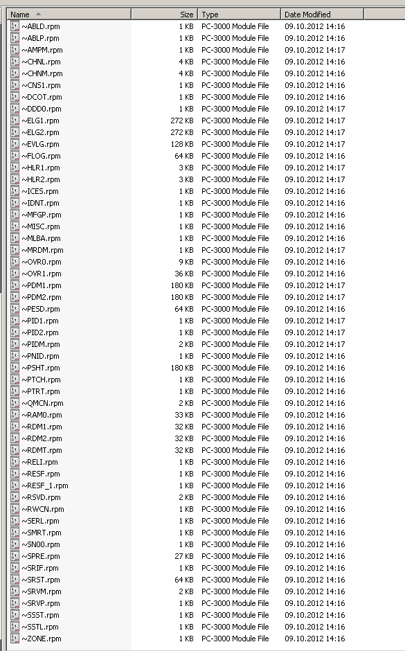

No, not from the patient, but I have them from the donor. I did try to get a full copy from the patient when it worked, but I couldn't get all of them. RDM1 is missing, for example, which is important. I stored modules to both DB and profile, and in both places this module is missing. Here's a couple of screenshots of the module files I have from donor and patient, from the profile folder.
patient modules
donor modules
