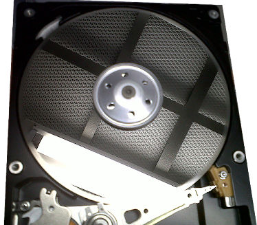

Thanks Databalance. I opened the drive in a cleanroom. One head is broked. and if you see in the attached picture there is a ring in the edge of the platter. Do you know if the heads replacement may works even that ring in the platter? Or the new heads will damage because of that? I have a donor in house, so I like to try if somebody have any experience with this situation.

For some reason I cant add attachments in this forum, whiles I resolve this with ACE can I send you the image to your email account?

Here is the photo
See the ring on the platter edge

The picture doesn't have very good quality, but if that in outer diameter is a ring, it's a huge one.
You don't have much chances really, as I even think SA is located there.
