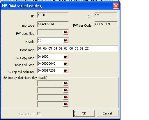

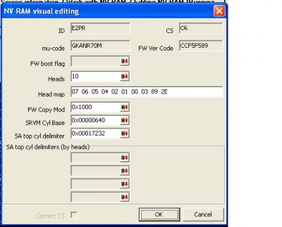

I run the utility by custom family (as 7210KLA3, HDS7210xxKLxxx0) and below is result of SA structure checking:
Selected family......................... : CUSTOM
Model by ID............................. :
ROM ID.................................. : 9āD
NV-RAM ID............................... : GKANR70M
USAG version............................ : GKANR70M
NV-RAM parameters
NV-RAM report
Loaded.................................. : Yes
Checksum................................ : Ok
ID...................................... : E2PR
mu-code................................. : GKANR70M
FW Ver Code............................. : 0xCCF5F589
Heads................................... : 10
Head map................................ : 7 6 5 4 2 1 0 3 89 2E
Module copy ABA modifier for SA......... : 0x1000

Below is picture from edit nvram:
edytor nvram.JPG (31.13 KiB) Viewed 7851 times
I tried rewrite nvram by nvram adjustment and .... nothing change - the same situation...
What i can to do it more for detect of disk ...???
Thanks for all answer :)
Igor
