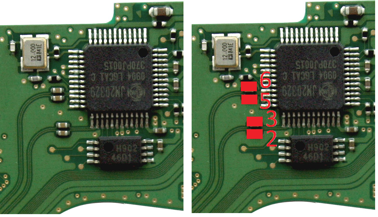

Hello guys

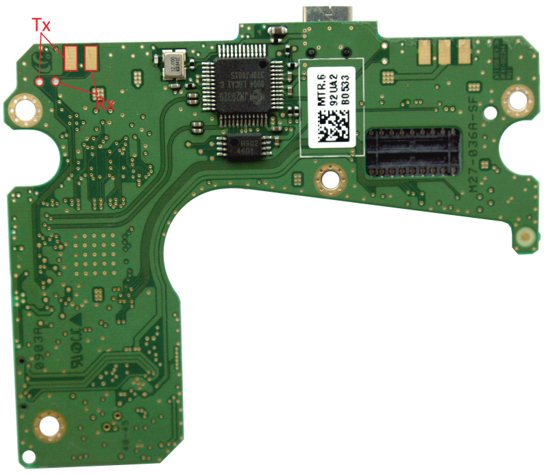

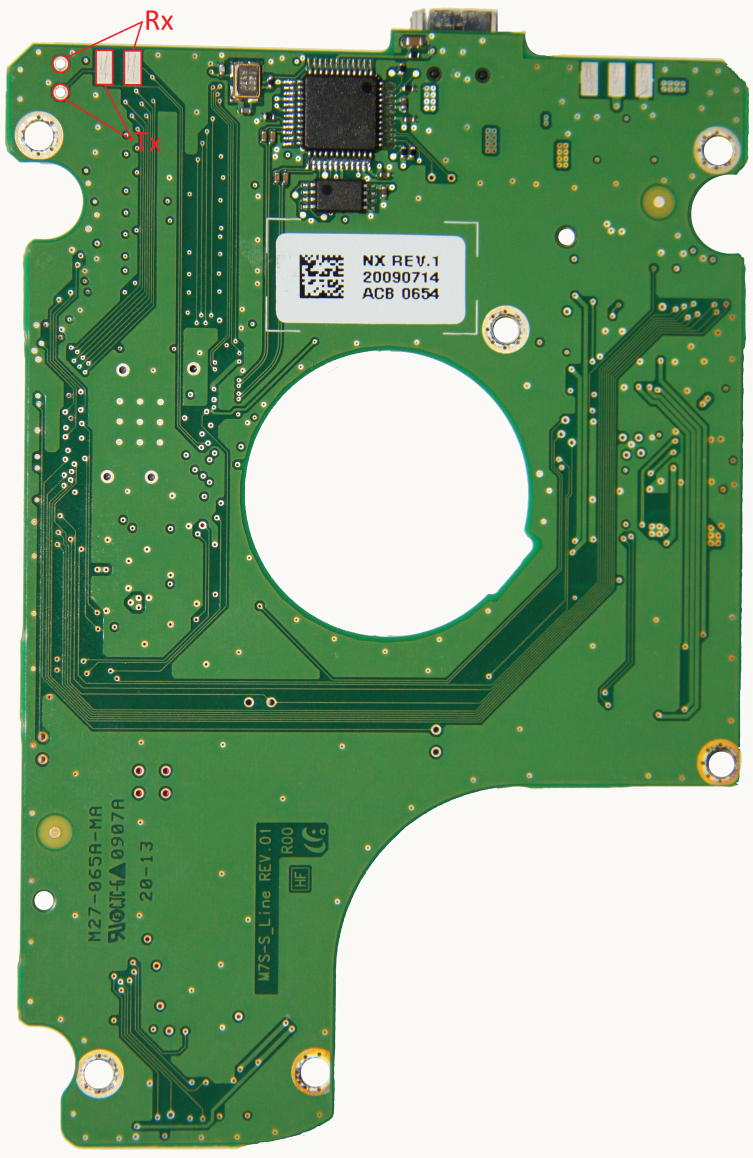

We can connect terminal to Samsung USB drives using diagrams below
For MT1
For M7S2

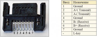

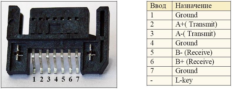

Sometimes we need to connect SATA interface to USB PCB. We can do it using next diagrams
This is schema of SATA connector

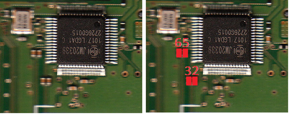

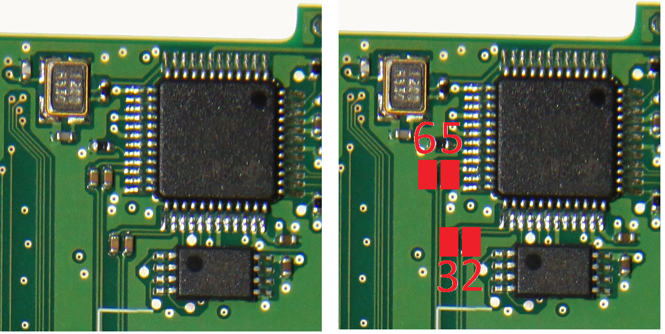

We should solder it on the place of 4 capacitors between SATA chip and USB chip. Capacitors should be unsoldered before.
When you unsolder one capacitor you get 2 pins. One goes to main chip and second goes to USB chip. So when we will unsolder 4 capacitors we will get 8 pins. We should solder sata connector to 4 pins that go to main chip.
On the diagrams below we can see places of capacitors (they are marked by red rectangles) and digits.
Pins number 3, 2, 5, 6 of SATA connector should be soldered to appropriate (by written digits) pins on the pcb.
Schema of MT1
SATA MT1.png (187.05 KiB) Viewed 14117 times
Schema for M7S2
SATA M7S2.png (164.49 KiB) Viewed 14117 times
Schema for M7E
SATA M7E.png (133.62 KiB) Viewed 14117 times
