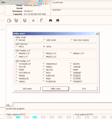

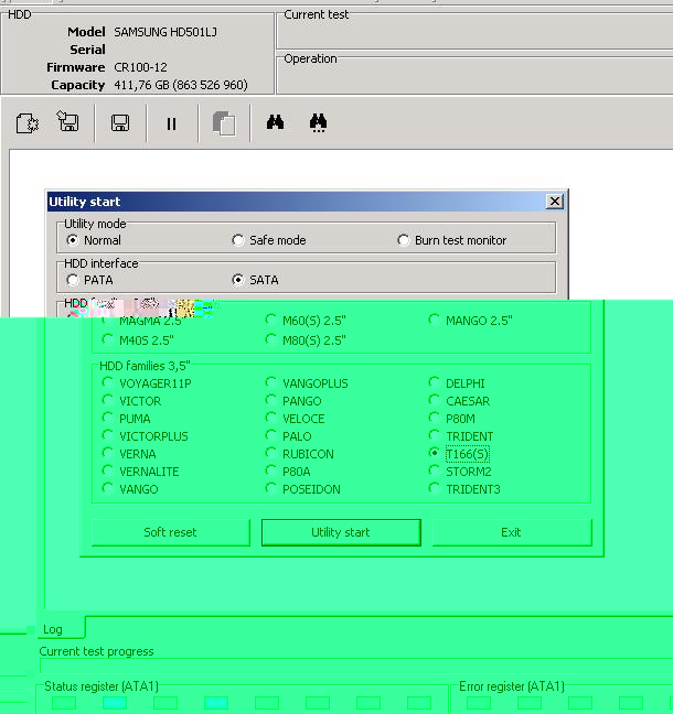

Hi to all,
Have this drive that in udma it start with no ID.

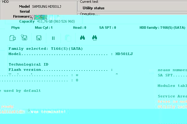

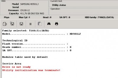

I enter the utility and make a soft Reset, and get DRD DSC, get out off Samsung utility and them enter again in the utility and can read the model off the disk.
When enter in the utility i can have the Model,FW, and size., but could not get the serial number.

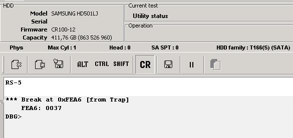

In terminal Show this:
Code: Select all
SPW 1.5G LinkOk! ADC: 0003
SpnOk
spd:  0000 0000 0000
H: +00000
ADC: 0004
DAC: 898E
Unlatch Tk: 00016F1E
Unlatch Done
ENG>SRV>
  SvoTbl Loaded
  BD
WriteSctLog -- buffer not valid
LED B5 0000
LED B5 0000
LED B5 0000
LED B5 0000
LED B5 0000
SRST
0x5B Maintenance read error
