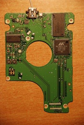

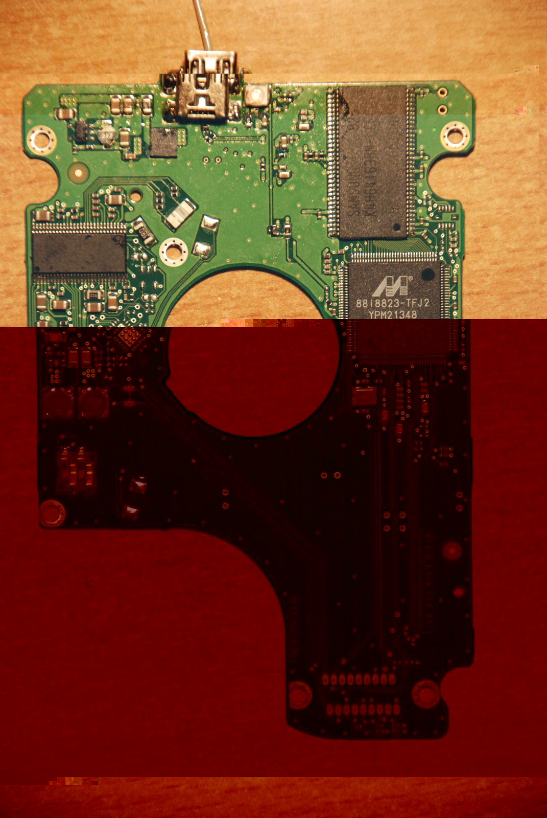

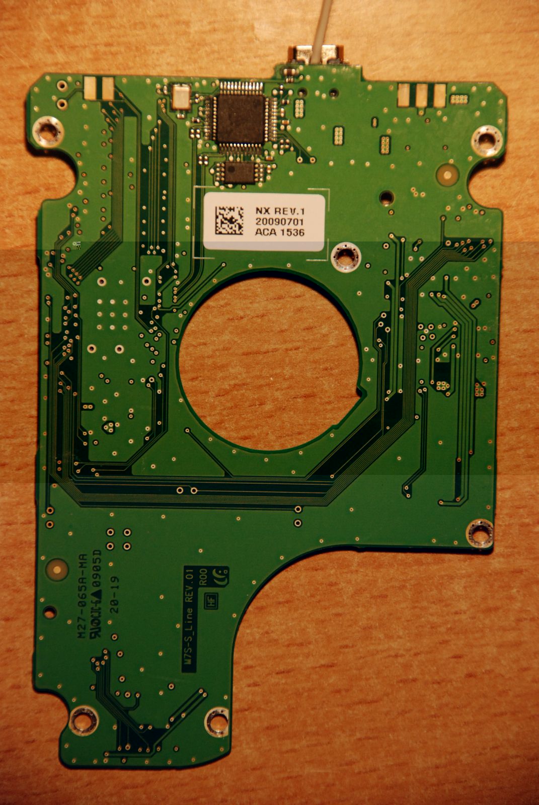

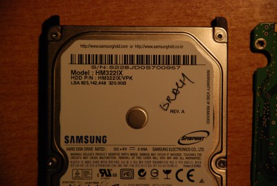

I have Samsung HM322IX. In this drive is USB interface only, which was cut off - it was under connection via USB. After solder new miniUSB plug, drive is not recognize - standard popup "USB Device Not Recognized". Probably USB controller is dead.
I don't have other the same PCB on stock.
1. Does anyone know, where I should connect SATA on this PCB - pinout?
2. Maybe there is SATA PCB compatible with this one. Which?

You should check drive family and find a PCB that matches family and CPU.

I connect SATA interface to this PCB. Data recovered 100%.

You can't buy it, you must make it ;)
Follow this topic:
http://forum.hddguru.com/samsung-hm322ix-usb-interface-fail-t18075.html
Connect additional capacitors before SATA interface. Look on other standard SATA PCB.
