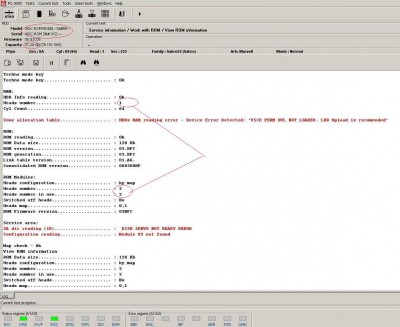

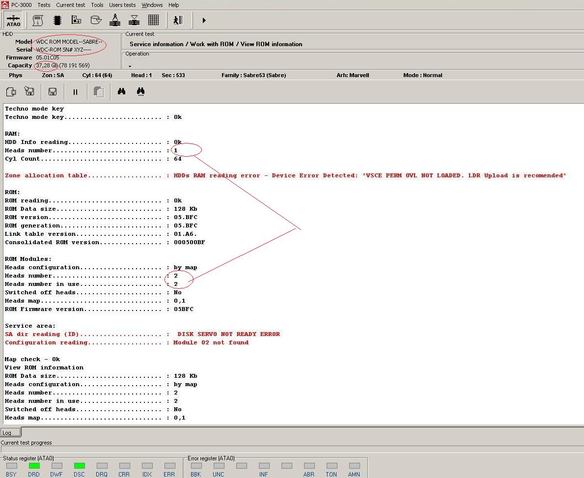

Problem hdd look jpg.
Hot swap solve is problem?
Or bad head?

"VSCE" error, usually is somehow related to heads. Also, if is clicking I would guess is heads.
Small chance it could be poor connection between HSA and PCB, but likely is heads problem.
