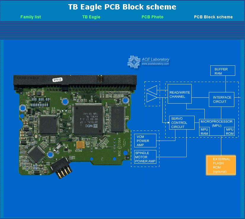

Well, this drive has an external ROM chip, you can rewrite it from dump on a programmer device.
Here is its location on attached picture.

I was afraid of that, but hoping the Gurus of ACE maybe now another way, to write back the Bin file.
In the past 25 Jears before at the time i'm working with comodore64 i'm jusing a EPROM programme, but now i dont having this. So i will must buy one of that. What Model you can sugest as good and not to expensiv in cost?
