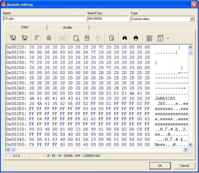

Re: WD2001FASS not showing family.
Postby ACE_Admin » 18.12.10, 16:50
It is possible to figure out the family by viewing C5 module from SA.
To enter WD utility you should enter it with some of the last added families, like DragFly X , Tahoe or other families from the end of the list.
The goal is to find a family that could access the modules. Module
