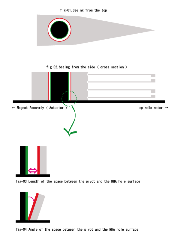

Hi !
I've been seeking for the solution for WD head alignment for over years.
According to the topic by N.C. , it seems the MHA's place ajustment is important .
Actually I had known about the outline already and have some success, but in these days
most of the patients are over 500GB and impossible to get data.
Today, I drew an illustration. I hope everyone uderstand what I want to express. :oops:
Now the question is "What should I adjust ?"
The space between the HDA pivot and the MHA ?
The angle of those 2 parts ?
Best Regards
dai
