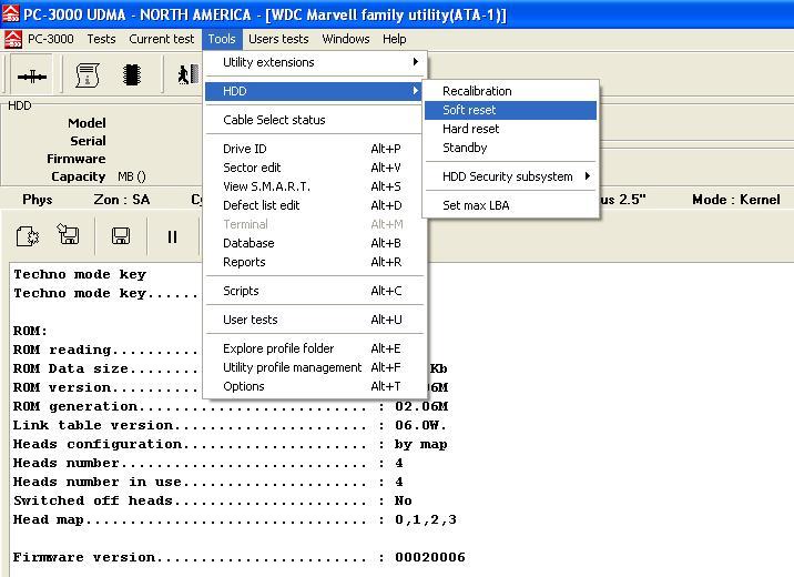

1. Open WDC Marvell utility startup window and select "Kernel mode" option. Then press "Autodetect". Utility should find the correct family.Leave the jumpers in master mode as they were before.
2. Perform command like its shown.
RAM Head map 1.JPG (44.85 KiB) Viewed 38354 times

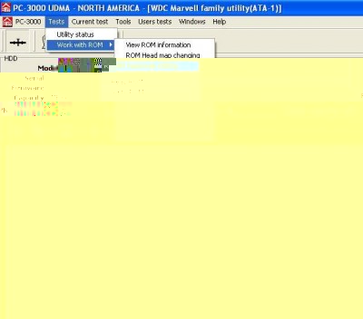

3. Next dialog box should be displayed to you.
RAM Head map 2.JPG (7.23 KiB) Viewed 39661 times

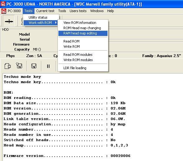

4. Here is the list of all physical heads. As it unknown what head is damaged , I set all heads to 0th head.
RAM Head map 3.JPG (7.24 KiB) Viewed 39654 times
5. After you pressed ok, perform "Soft reset command" the drive will turn on its motor and this drive id will be displayed correctly.You can preform command Tools->Drive id to refresh the data.
RAM Head map 4.JPG (36.4 KiB) Viewed 38353 times
If it is not possible to start up the drive from 0th head, you should try set 1st instead of it.
6. After the drive started to spin and its ID was shown, go to "RAM Head map change" menu again and set the head map to its original values.Then set soft reset once more. Now the drive is ready to read its data.
7. Run DataExtractor and build heads map. After the head map was built, you can read the data from healthy heads.
