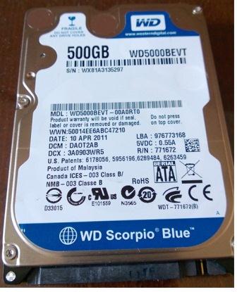

The drive stop spinning after I hear 5 times a quit sound. It should be a bad heads.
I have the last version 5.2.4. The drive is recognized with Marnier but on the top of the HDD, its written Scoprio Blue (see photo)
