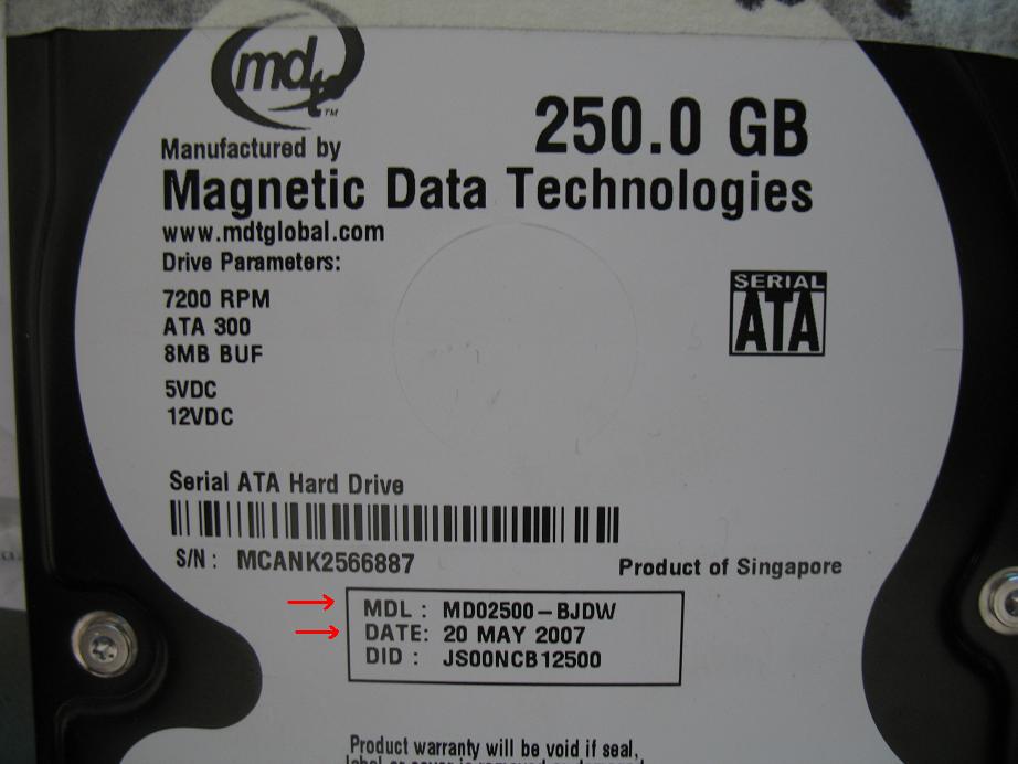

Hi All,
This drive is a WD drive refurbished/rebranded by Magnetic Data Technologies
MDL MD02500-BJDW
PCB Label 2061-701335-B00 AG
Does anybody know what is the exact WD equivalent model ( detected family is Hawk but i need model code xx)?
Need to change heads

Hi;Spark!
I put your SerialNo. into our database not exactly but you have mcank2.... and ours WD2500JS-xxMHB0 have WCANK2...
So Ithink with 90 % percent probability its a WD2500JS-..MHB0.
Hope this helps!

Postby AJ2008 » 09.05.12, 10:55
It is: WD2500JS-00NCB1

AJ2008 wrote:It is: WD2500JS-00NCB1
Yes I confirm you are right , is Hawk, in the meantime problem solved.
