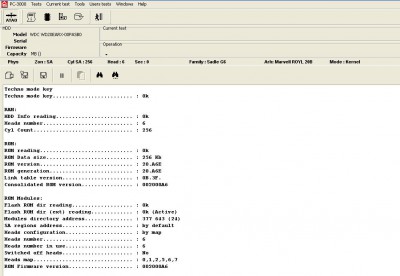

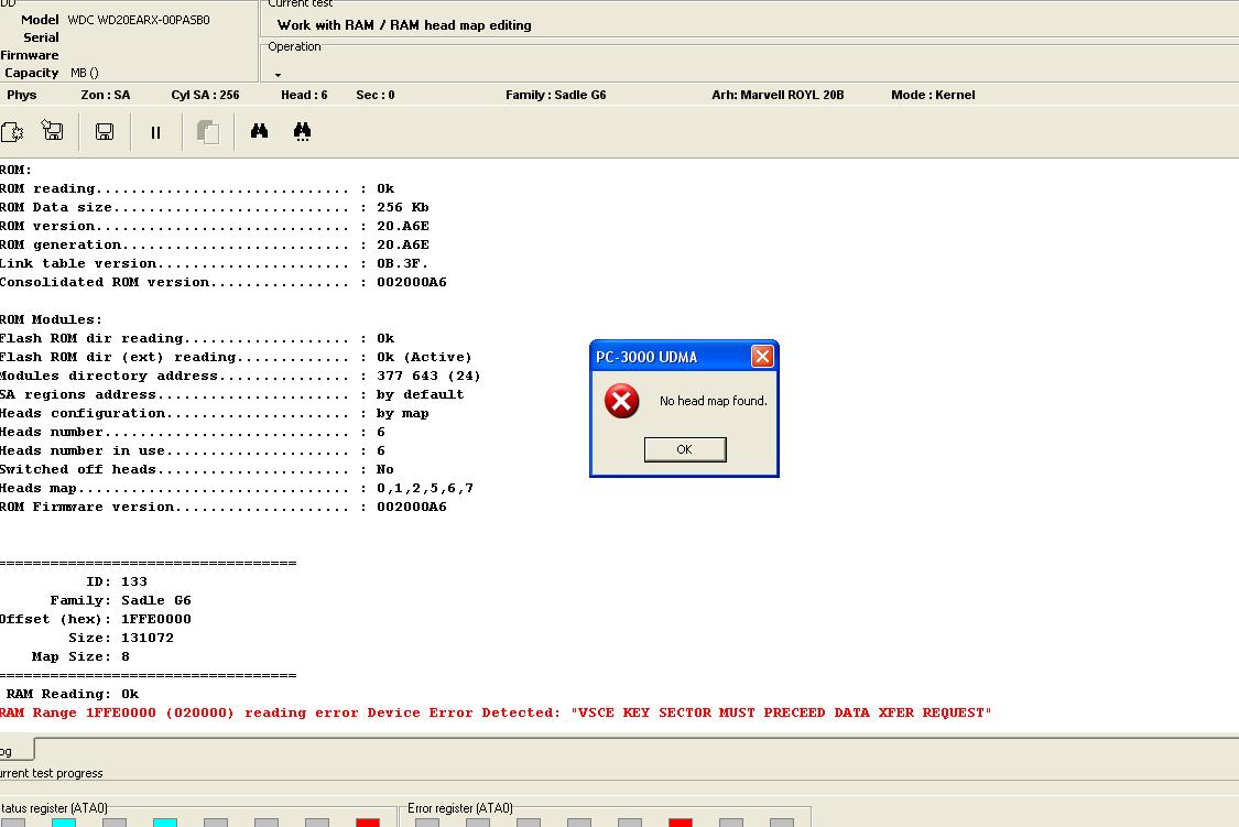

Would you please give me some advice about a WD20EARX 00PASB0. it starts with cliking sound for a few second and you can see the result as :
WD--Sadleg G6-1.JPG (86.43 KiB) Viewed 3435 times
WD--Sadleg G6-2.JPG (102.61 KiB) Viewed 3435 times
it seems I have to have some ROM or LDR !!

View 90 module information . Is it original Rom ? . recovery 47 module . Rom images are empty in this model . You can use "New method of handling WD Caviar HDD Green, Blue and Black" topic and You need loader with the same FW version .
