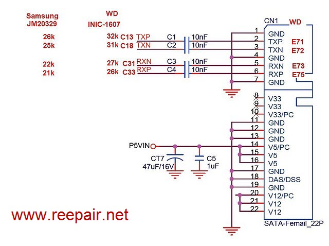

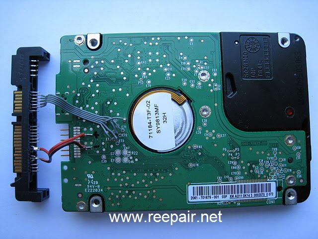

hello all
fist
desolder these cap
C31 C33 C13 C18
then see pics

thanks arvika, apparently a western digital WD2500BMVV-11A1PS0 doesnt have E75 only E74
E71 - TXP
E72 - TXN
E73 - RXN
E74 - RXP???
there is a E75 but i think its connected to other chips, too far from Initio 1607
