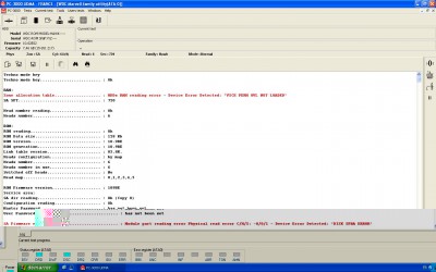

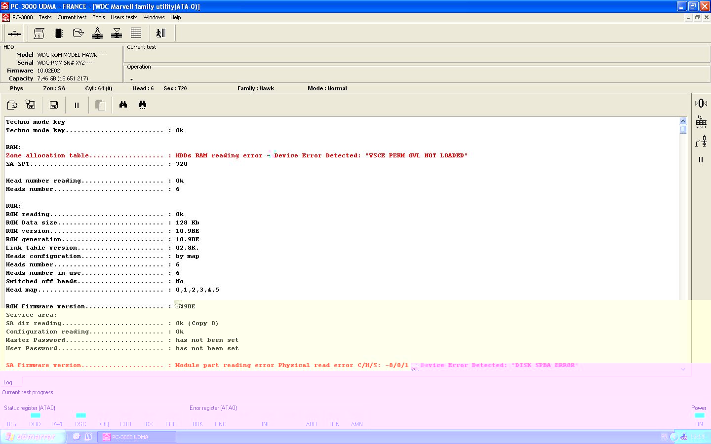

Here is a WD2500JS-60NCB1, not knocking, sounds that it initiliazes, but recognized in "Marvell".
14311 Utility.jpg (167.83 KiB) Viewed 3684 times
I know that PCB has been removed (screw weren't enough screwed) but I don't know if this is the native PCB. Hdd falls down last year, was given to someone but my customer don't know what he has done, she says probably nothing. According to her, the PCB is the native.
Hdd Resource Back Up is done.
I don't know where to begin now. I don't want to do something wrong as it's maybe wrong ROM.
I have a donor which has exactly the same label (same model, same manufacture day, same DCM).

Re: WD2500JS-60NCB1 sounds well but not recognized
Postby AJ2008 » 08.07.10, 15:03
1E: 0 : B : -3: 0: 361: 23:No : : : : : :Loaded part of microprogram code
1E: 1 : B : -3: 1: 361: 23:No : : : : : :Loaded part of microprogram code
41: 0 : As : -3: 0: 394: 19:No : : : : : :Adaptive data
41: 1 : As : -3: 1: 394: 19:No : : : : : :Adaptive data
04: 0 : B : -3: 0: 417: 9:No : : : : : :Family models configuration (Main)
04: 1 : B : -3: 1: 417: 9:No : : : : : :Family models configuration (Main)
0C: 0 : B : -3: 0: 430: 4:No : : : : : :Models table
0C: 1 : B : -3: 1: 430: 4:No : : : : : :Models table
53: 0 : As : -3: 0: 438: 2:No : : : : : :Parameters table 4
53: 1 : As : -3: 1: 438: 2:No : : : : : :Parameters table 4
11: 0 : B : -8: 0: 0: 282:No : : : : : :Loaded part of microprogram code
11: 1 : B : -8: 1: 0: 282:No : : : : : :Loaded part of microprogram code
21: 0 : B : -8: 0: 292: 64:No : : : : : :S.M.A.R.T.
21: 1 : B : -8: 1: 292: 64:No : : : : : :S.M.A.R.T.
61: 0 : B : -8: 0: 360: 27:No : : : : : :Loaded part of microprogram code
61: 1 : B : -8: 1: 360: 27:No : : : : : :Loaded part of microprogram code
4C: 0 : B : -8: 0: 391: 13:No : : : : : :Loaded part of microprogram code
4C: 1 : B : -8: 1: 391: 13:No : : : : : :Loaded part of microprogram code
06: 0 : B : -8: 0: 414: 9:No : : : : : :Family models configuration (Alt2)
06: 1 : B : -8: 1: 414: 9:No : : : : : :Family models configuration (Alt2)
4A: 0 : As : -8: 0: 427: 4:No : : : : : :Adaptive data
4A: 1 : As : -8: 1: 427: 4:No : : : : : :Adaptive data
36: 0 : Ad : -8: 0: 435: 2:No : : : : : :T-List Module
36: 1 : Ad : -8: 1: 435: 2:No : : : : : :T-List Module
All these modules not read, and many are very important to HDD operation. You have Overlays, defect tables and other adaptive info not read. I think there my be some other hardware error here, if no other hardware error and all modules actually bad I do not think data access can be made.
Maybe you can try read Plist alone to donor and regen translator on donor and maybe you will be lucky with hotswap if donor is close match...
rcz
Posts: 71
Joined: 05.05.09
Reputation: 1 / (14)
Postby rcz » 08.07.10, 16:00
So I think I'm lucky :roll: .
I did it: it produces many ABRT errors but it seems there is no shift, I managed to open few photos without errors.
I'll report the result or if I have troubles.
Thanks a lot :!:
Postby AJ2008 » 08.07.10, 16:53
Good job 8)
