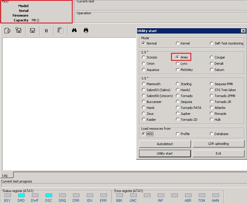

Hi Have this disk that the heads where stuck in the platte.
Remove the head to the park zone.
I could detect the disk and the DRD / DSC
Save the resources disk to the database
I start copy data in reverse.
But now the disk is not detect anymore.
When i start the utility it give-me two RED errors.
Code: Select all
Techno mode key
RAM:
Zone allocation table................... : HDDs RAM reading error Techno CMD sending error Device Error Detected: "VSCE PERM OVL NOT LOADED"
SA SPT.................................. : SA SPT determination error Techno CMD sending error Device Error Detected: "SERVO ERROR CODE BASE SvirLatchHang"
Head number reading..................... : Ok
ROM:
Flash Dir reading....................... : Ok
ROM reading............................. : Ok
ROM Data size........................... : 192 Kb
ROM version............................. : 09.9NF
ROM generation.......................... : 09.9NF
Link table version...................... : 03.8E.
Heads number in use..................... : 4
Head map................................ : 0,1,2,3
Firmware version........................ : 0009009N
Service area:
SA dir reading.......................... : Unknown error. Code(0)
SA Copies avalabled..................... : NONE
Configuration reading................... : Module 02 not found
What should i do next.

Open Again the disk in the clean room, and give power to it.
I Notice that the disk try to read the SA ok, wait some time and read it and detect it in the PC.
Next
I connect to the pc3kudma , and i am getting the data again. :)
