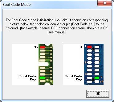

Can someone tell me where in the manual are the instructions and pins for Seagate thin Julius1 please, I was able to gain access and read the ROM, I shorted the pin 2 and 4 of the ROM chip. Now that I want to write the ROM back to the PCB after modified the heads adaptives, now I can't get it to boot code mode to write back....

It will help if you cut the pins on the Marvell Chip to gain access to the ROM! :P
