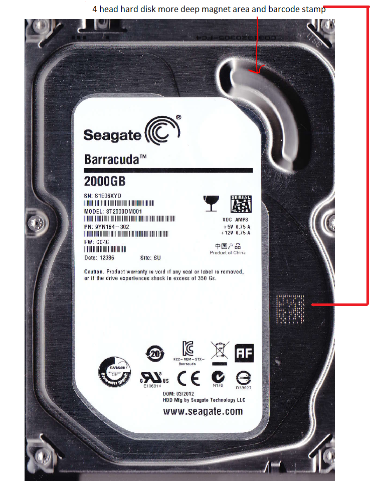

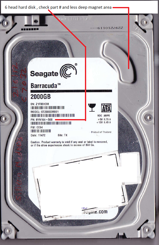

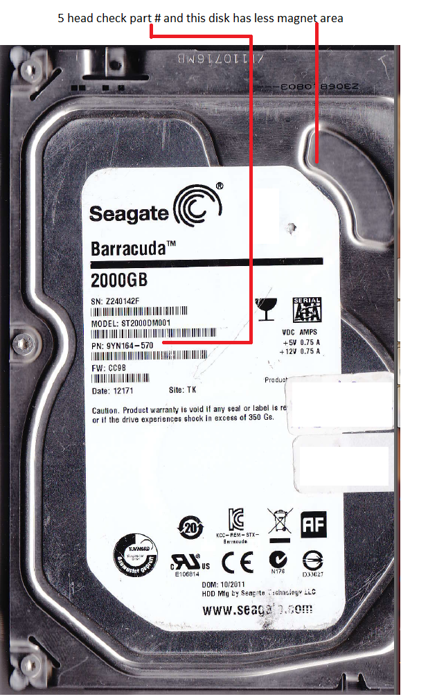

I have received 3 Seagate hard disk with head crash, all the 3 drives have same model, but part # are different and also have different head configuration. I have observed some difference marked it. Check Images for difference.
TYPE 3 WITH LESS DEEP MAGNET AREA 6 HEAD.PNG (780.26 KiB) Viewed 2638 times
TYPE 2 WITH LESS DEEP MAGNET AREA 5 HEAD.PNG (844.21 KiB) Viewed 2638 times
TYPE 1 WITH DEEP MAGNET AREA 4 head ( barcode stamping).PNG (845.16 KiB) Viewed 2638 times
