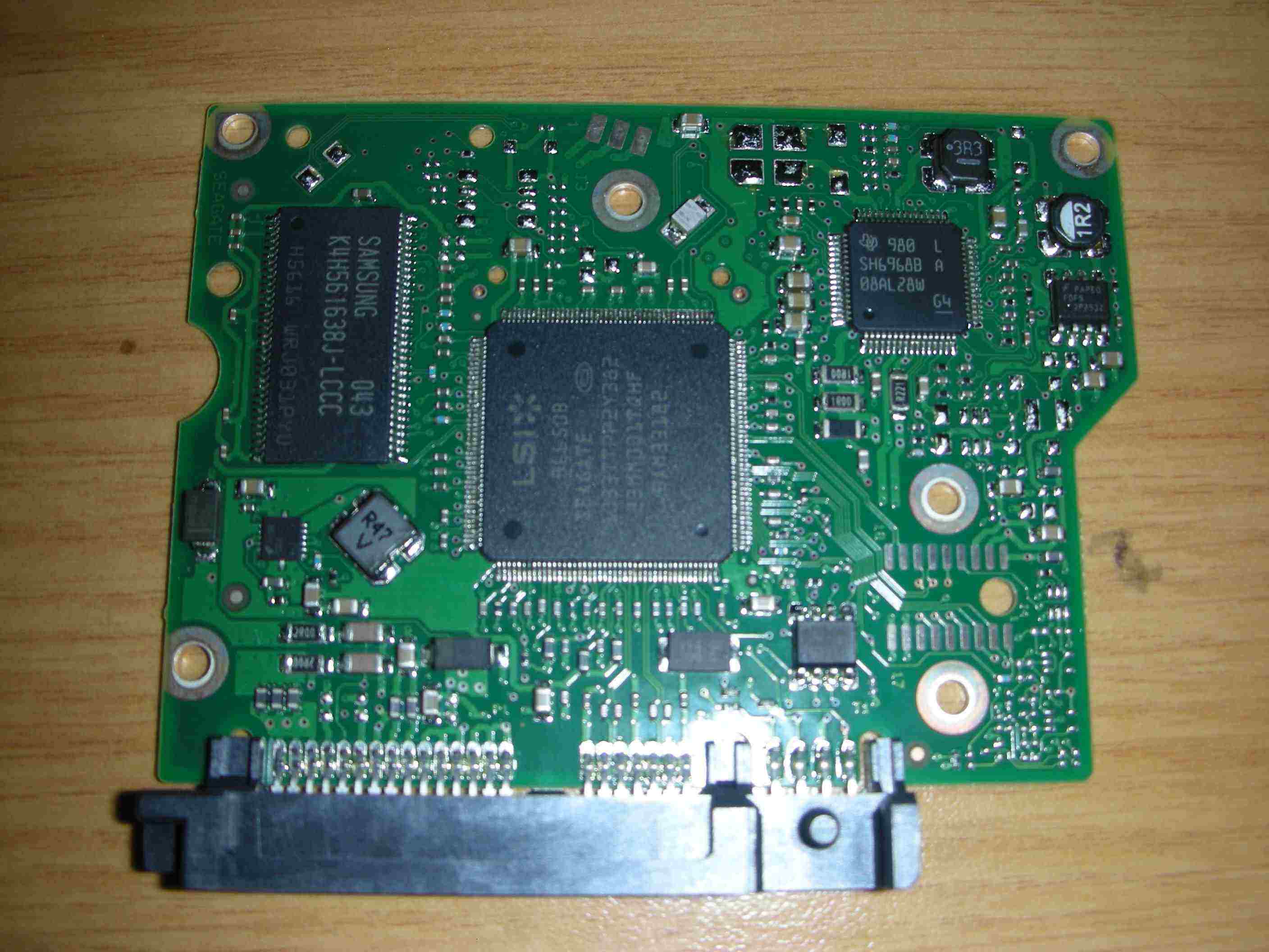

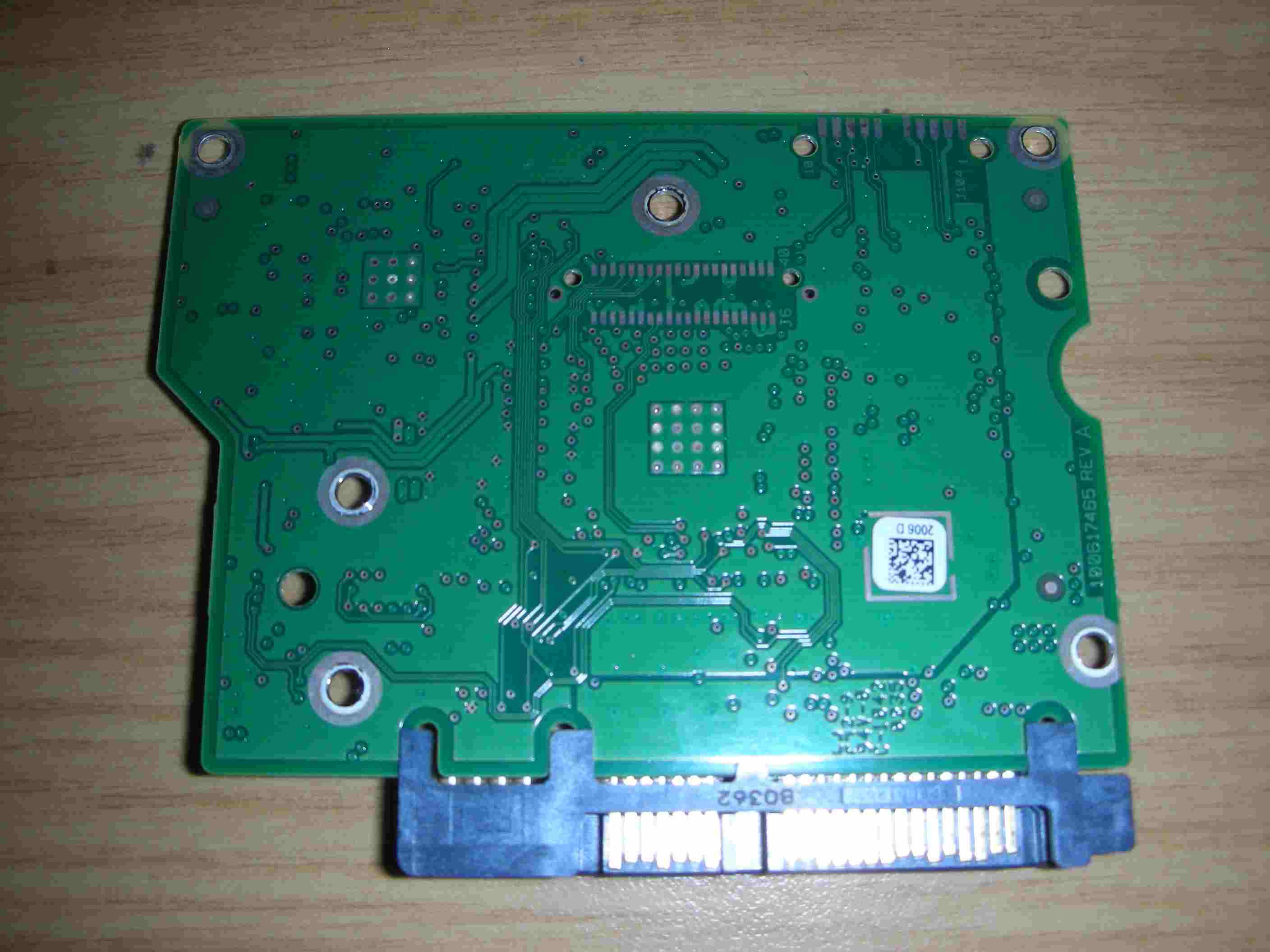

I'm searching the shorting points for seagate pcb 100617465 on a ST2000DL001 drive. Isolating motor contacts doesn't work

Post clear image of the pcb here

This is the pcb photo.

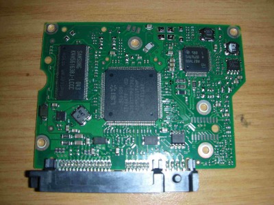

the image is not clear try this

Thanks a lot for your answer. It is working now.

Only for info: shorting points also the same in PCB 100603204.
After using the shorting points I got access via terminal and made "Clear Smart" via terminal
F3 T> /1
F3 1> N1
switch off/on hdd, I got full access to the HDD
