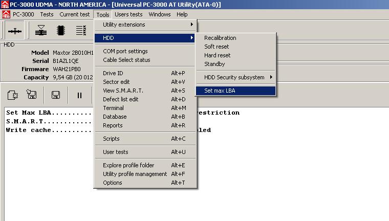

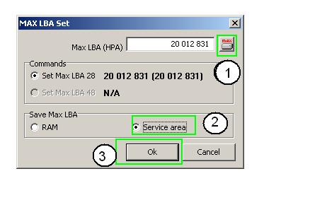

Postby ACE_Admin » 02.11.11, 08:34
Tell me, have you tried to apply "Set max LBA" command on this drive? Please check my pictures below.

Postby aribot » 02.11.11, 10:34
Hi Roustam,
i've tried with no success. Error showed!
It's possible to access the module where MAX LBA is and modify it manually, and then write back modules?
