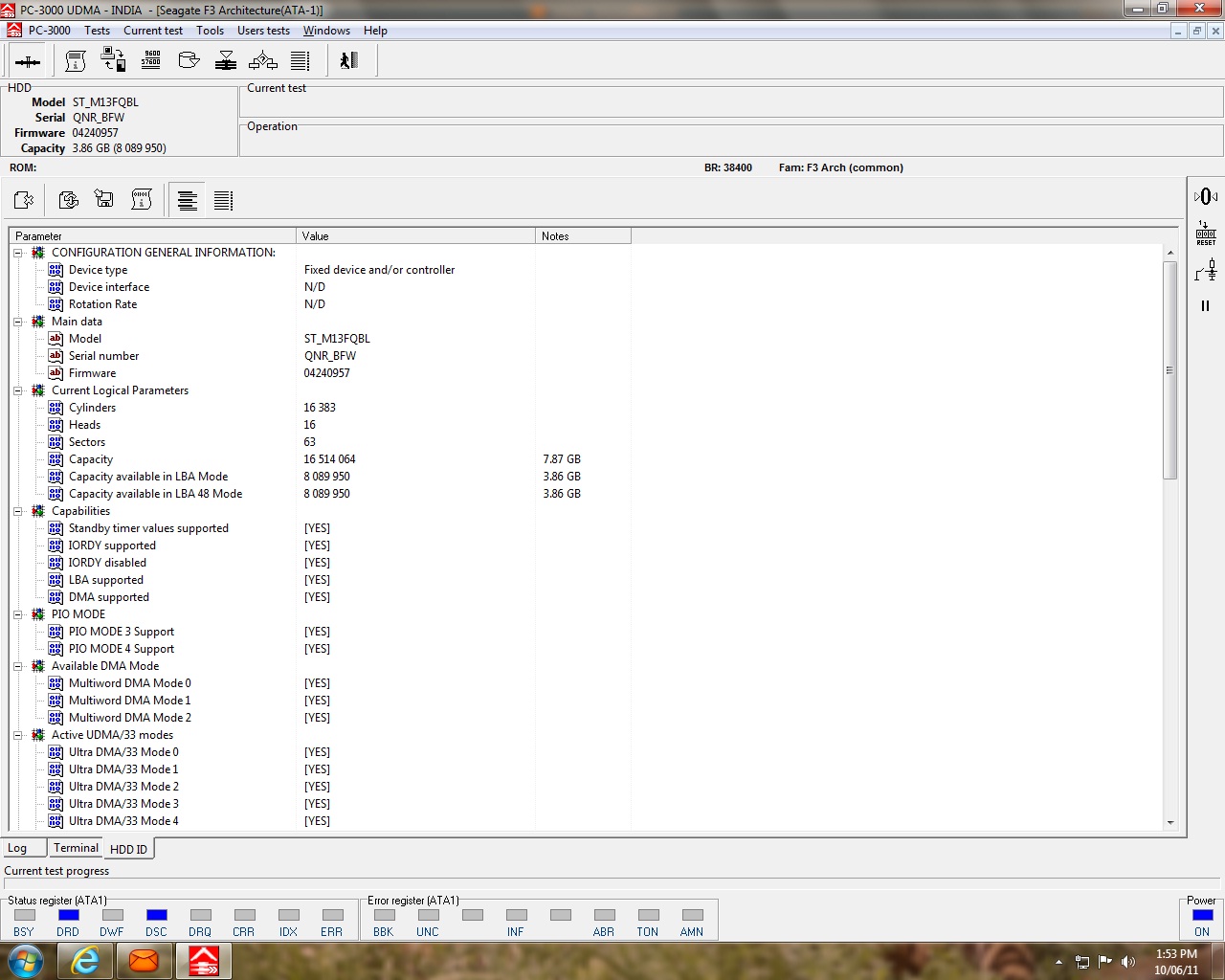

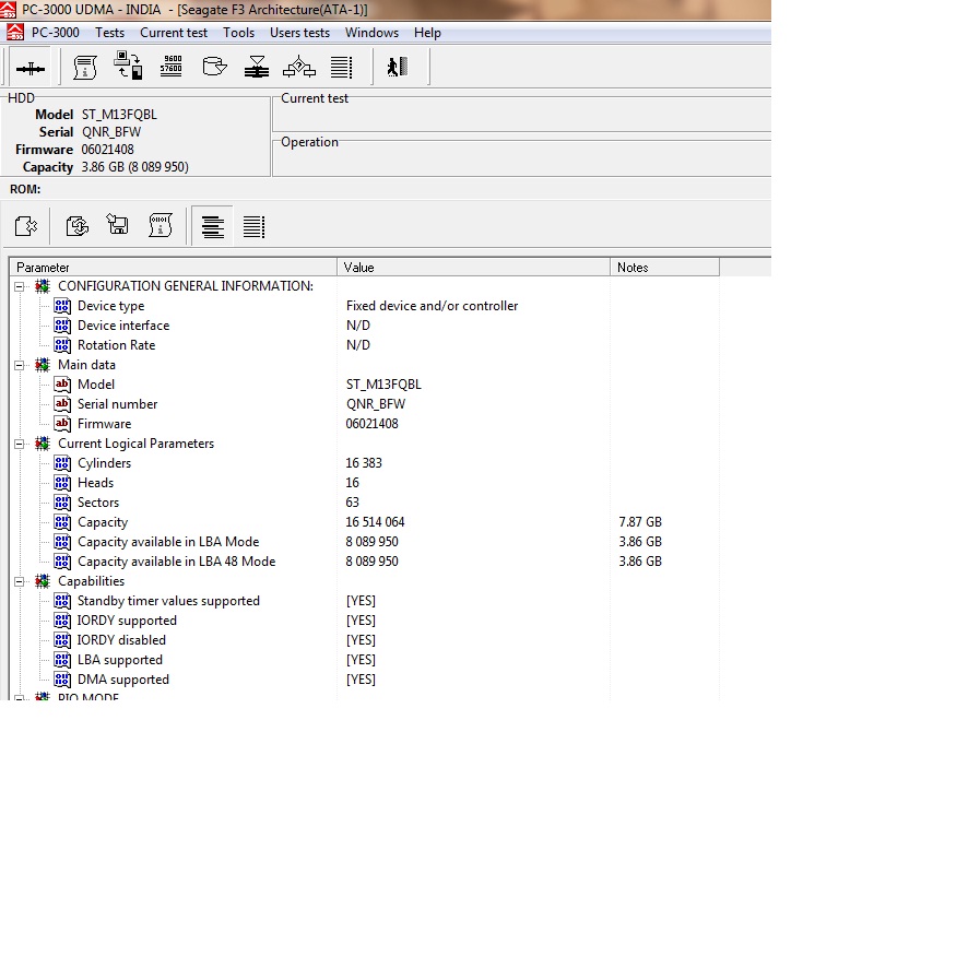

Today I got one more case same problem,
I have disconnect the Board from the Hard disk and switch on the utility, it is giving READY status,
when i open the utility HDD ID and Serial No. and Capacity is not showing properly.
