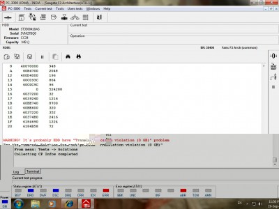

Postby datacare » 19.09.10, 20:27
I need help to solve this one
Re: ST3500418AS-FIRMWARE-CC34-0GB Problem
Postby AJ2008 » 20.09.10, 09:54
Can you reach a prompt at Terminal? You should check with CTRL+Z in Terminal window. If you can reach F3 T> then try repair with manual command.. If cannot be reached, you will probably need to short circuit read channels.
