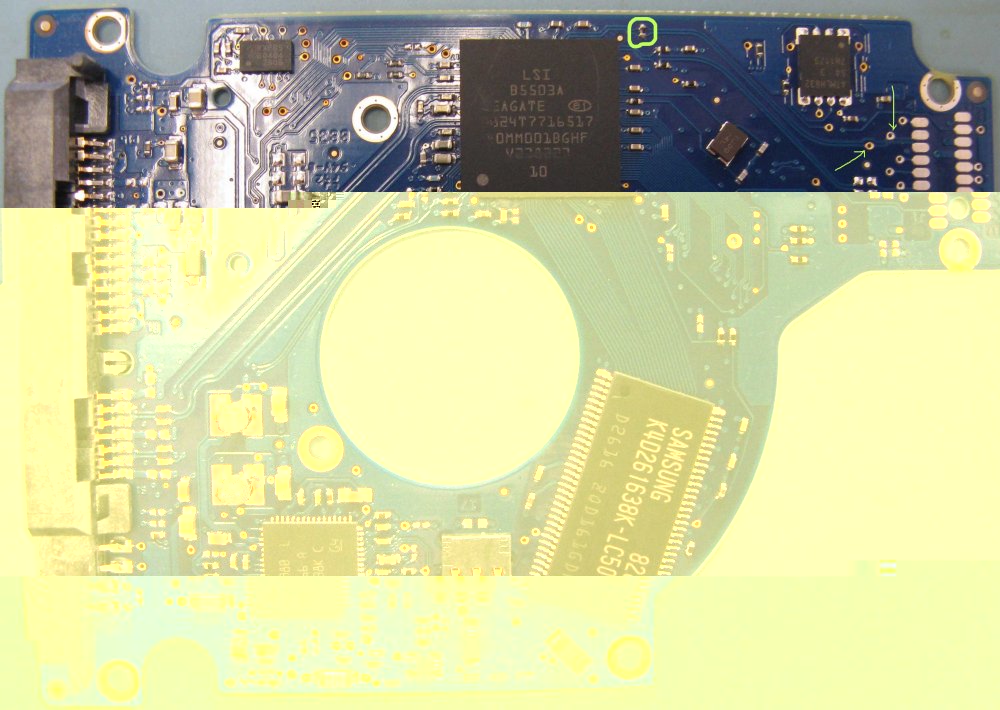

I thought it is a good idea to create a topic with photos that show shorting points location on Seagate 2.5 inch drives, since this is not described in available F3 Seagate utility manual.
Seagate 7200.3

Here are Momentus 5400.5 Momentus drive shorting points
