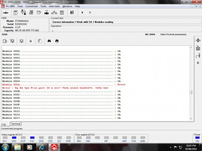

when i open utility in terminal log i got the following message
"SIM ERROR 1002"
i have checked module, there is some modules are corrupted.
is it possible to repair it.
With regards
Sundar Rajan.P
ST3500418AS-FIRMWARE CC37-MODULE PROBLEM

It is detecting properly, but when i try to copy the module i got the following error
Test : Modules reading
Reading modules to profile folder
Folder: C:\Program Files\ACE Lab\PC-3000\Bin\!Profiles\SgF3\F3 Arch (common)\ST3500418AS-CC37-5VM3K1M2\Data\ModDir\
Error starting command "En Tech" (Drive is not ready)
Soft reset ...

Module 000A........................................................... : Error
Error : Rq Rd Sys File part ID A err! Tech state 0x440472. Offs 0x0

HDD power supply switching OFF/ON...
Module 0026........................................................... : Error
Error : Drive not ready
Module 0027........................................................... : Error

Module 0033........................................................... : Error
Module 0034........................................................... : Error
Module 0035........................................................... : Error
Module 003A........................................................... : Error
Modules reading process completed

datacare wrote:Module 002B........................................................... : Error
This module is part of translator and if not readable will not allow data access, but I think this module is loaded correctly to RAM because LBA value is normal.
Are you able to read any information from suface, or maybe you should try Surface Verification to try test surface access.
