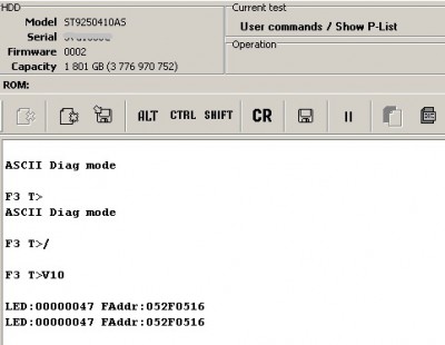

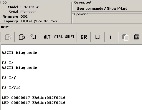

Hello, I have strange issue on Seagate 2.5'' 7200.4 ST9250410AS FW version 0002SDM1
Drive calibrates, reads ID but reports incorrect capacity 1.8TB. Cannot access sectors (ABR).
I am able to read/write modules. Incorrect capacity remains even after changing it in HDD id editing (it was correctly displayed there).
Cannot display P-list, Alt-list (drive hangs but remains DRD DSC). Cannot disply SMART (ABR).
User partition format succesfull but still the same issue. Smart clear reports cleared but still cannot be displayed (ABR).
PCB is native (reported same S/N as HDA).
Any idea what should be wrong? I have not faced this issue yet.

PCB swap helped.
