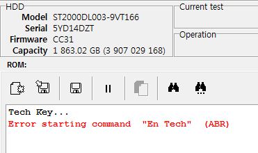

Hi.
i have ST2000DL003(barracuda LP or Green).
it's like F3 series HDD lock.
sounds like ready state but can't recognize.
so i tried solution for HDD lock.
but can't resolve.
after pcb short method hdd can recognize.
i can see Model, Serial, Firmware, Capacity on utility.
but can't access SA, data area.
i tried smart clear, g-list clear, translator regenerate.
but can't resolve this case.
