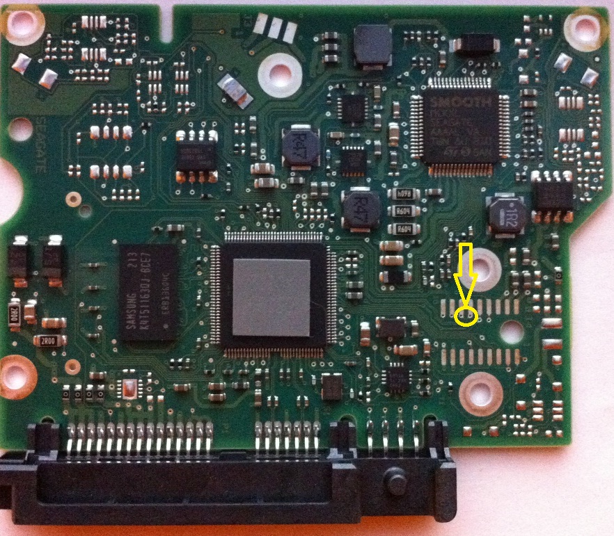

The drive does not let you terminal in or control z, is there points on the pcb where you can short the pcb and get the terminal working?

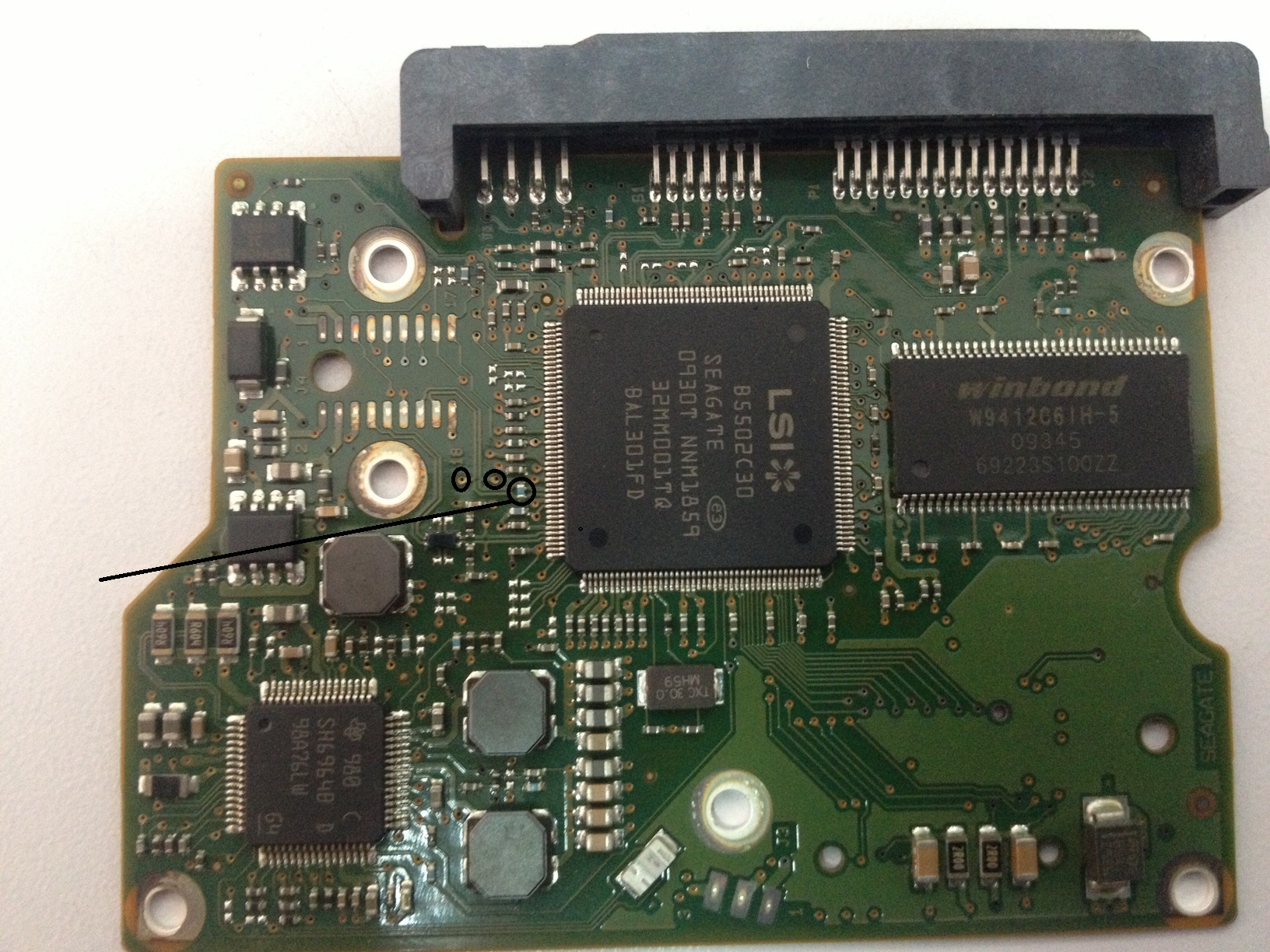

Please provide the board picture into the forum.
Usually, reading channel lines are shorted across with element. So you can check my picture and find it by yourself.
Check my example picture and see for the same lines on your pcb.
Black circle show the element that shorts two lines.
Seagate 7200.12 100535704 REV B.JPG (690.13 KiB) Viewed 5155 times

The pic for this pcb is attached... 100664987 rev A. The one posted is not the one for this drive..
This is for the ST3000DM001 CC43
ST3000DM001 FW CC43 pcb 100664987 REV A.JPG (1.67 MiB) Viewed 5149 times

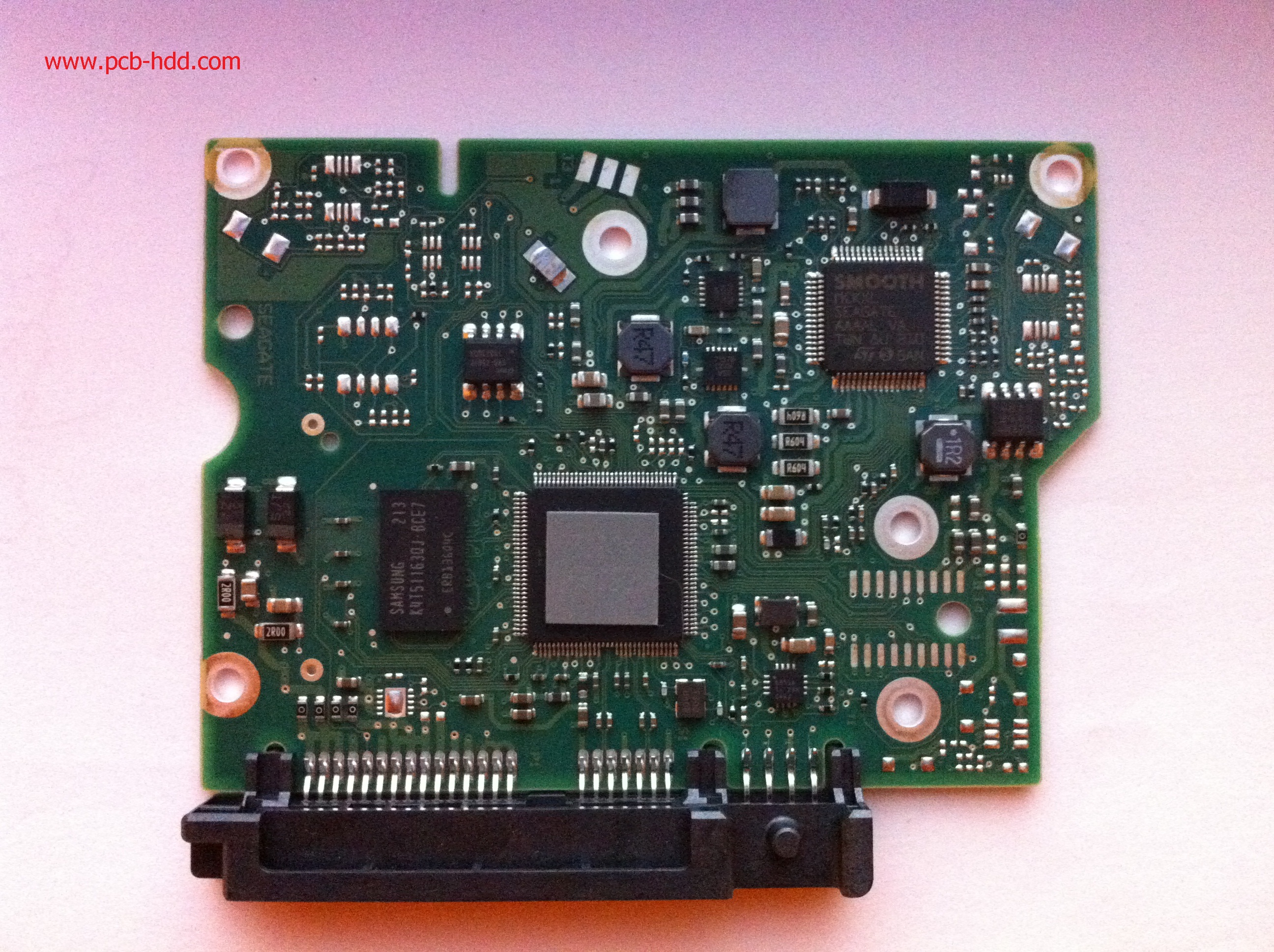

Maxim_TS
Posts: 344
Joined: 27.03.13
Reputation: 18 / (175)
Re: ST3000DM001 BSY DSC DRD and motor stops cannot terminal
Postby Maxim_TS » 16.04.13, 09:34
Try this points
shortcut_ST3000DM001 CC43.jpg (333.33 KiB) Viewed 5123 times
