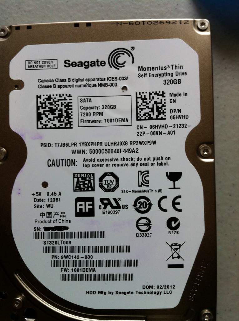

Does anybody know anything about these new Seagate ST320LT009 Self Encrypting Drives?
I got one in that was clicking.
I replaced the heads and it seemed to be imaging good on Data Extractor (all green) until it crashed.
When I looked at my image drive it was all full of zeros :cry:

I have one with parked heads. Unpark and recovery 100%. Probably controller encrypt data, so maybe you have problem with PCB.
