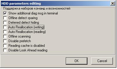

Please, turn on "show additional diag messages in terminal" option and try to clear smart once more.
Then terminal should display you more messages, copy them here.

I can't find the Parameter"show additional diag messages in terminal".
Please tell me how i can find them.
