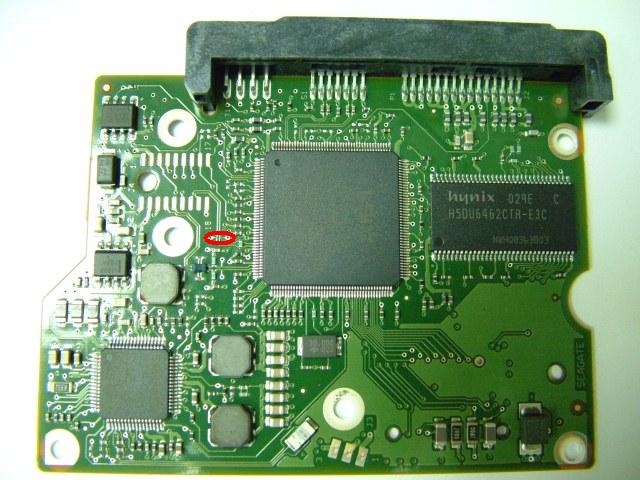

Hello everyone,
I have 3 HD ST3250318AS model 7200.12 family is the problem BSY LED on.
- I tried the prodecure short and I had no success. When I run this procedure by giving the engine stop short, but then the rotation starts again.
- Can someone help me?
Re: HD ST3250318AS Family 7200.12 BSY LED is on.
Postby ACE_Admin » 20.07.11, 09:07
Is there any output within the terminal, after you power this drive on?
Also, have you tried to short the points and press ctrl-z keys together?
