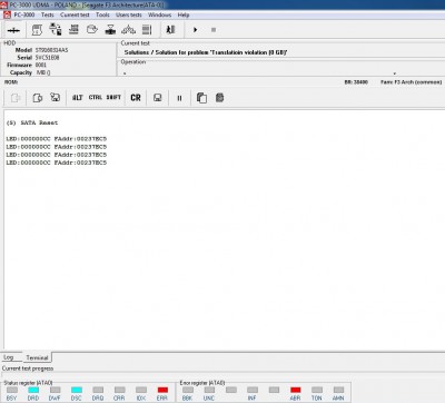

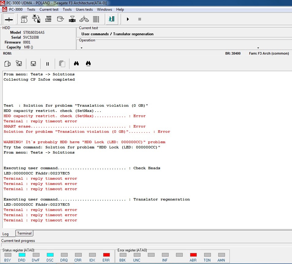

Today I've encountered following problem with Seagate Momentus 5400.6, after powering on it was recognized and DRD, DSC leds appeared.
After opening utility, the capacity was ( )MB, so I tried to use the solution, but without good result, You can see the attachment.

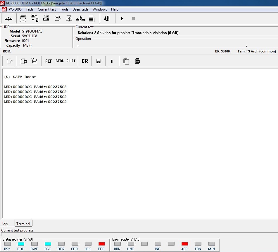

Tried also to read response from terminal, it showed only:
Rst 0x08M
After trying to regenerate translator, it failed, but terminal showed a few responses:
LED:000000CC FAddr:00237EC5
Would You please provide advices, how to solve this problem and what do You think the problem is related to?
Swapping the heads could solve the problem ?
Thanks for answers folks!
