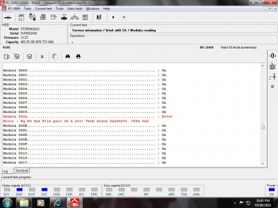

Is it possible to repair the above module

this module is of no importance for disk operation or data access. this should not cause any problems even if you dont repair.

totally agree with u not important at all
ur drive should be ok
