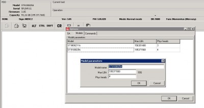

Hi Acelabs support,
Have this disk that is not detect by the seagate utility
ST9100825A
I went to the
tools-->options --> seagate u5, baracuda xxx
models --> ADD
and i put this values
model : ST9100825A
lba : 195371568
heads : 4
Now when i connect the disk the utility just know him
the Sign is MERC2 is this a problem ? because this family is just Mercury ?
Thanks for explain

This one have a CE Error Problem, but i could clone it very well.
Just would like to know how can i create new drives if possible to do it?

here is a picture :
where i create the disk
