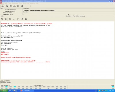

I tried 'solution for problem "hdd lock"' but error message
Postby Sung-Kwon Jung » 25.03.09, 09:09
I have seagate hdd 7200.11
please tell me how to do
Re: I tried 'solution for problem "hdd lock"' but error message
Postby AJ2008 » 25.03.09, 10:15
Your 7200.11 has new unsupported firmware which does not allow terminal access. PC3000 alone is not yet able to repair this hdd.
Postby AJ2008 » 27.03.09, 15:19
The new update will not help. The HDD itself seems to block out any terminal access at all. Shorting the PCB locations as instructed in the new F3 manual did not help me when I had this problem, but there is a solution via using a donor with supoprted fw.
