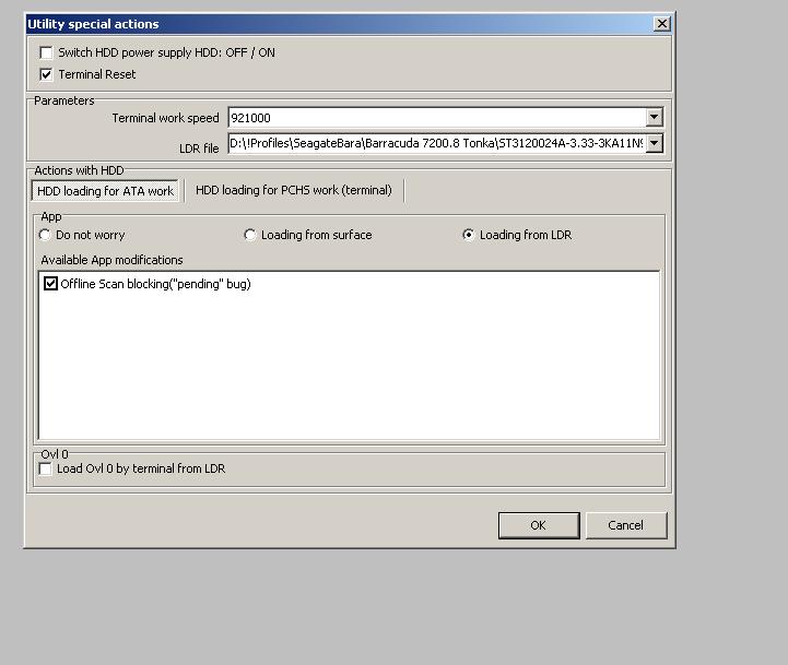

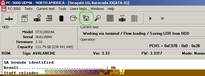

A new function appears in 4.04 version. It is possible to start up this drive from loader. You can create a loader by clicking "Floppy disk" Icon in seagate utility.
At the second step you have to minimize Seagate utility and start new task in Data Extractor.
And start up the drive from that loader.
[img]http://www.acelab.eu.com/forum/download/file.php?mode=view&id=23&
sid=29889263df2ceed03911601b373514ab[/img]
Then tick "Pending bug" option
