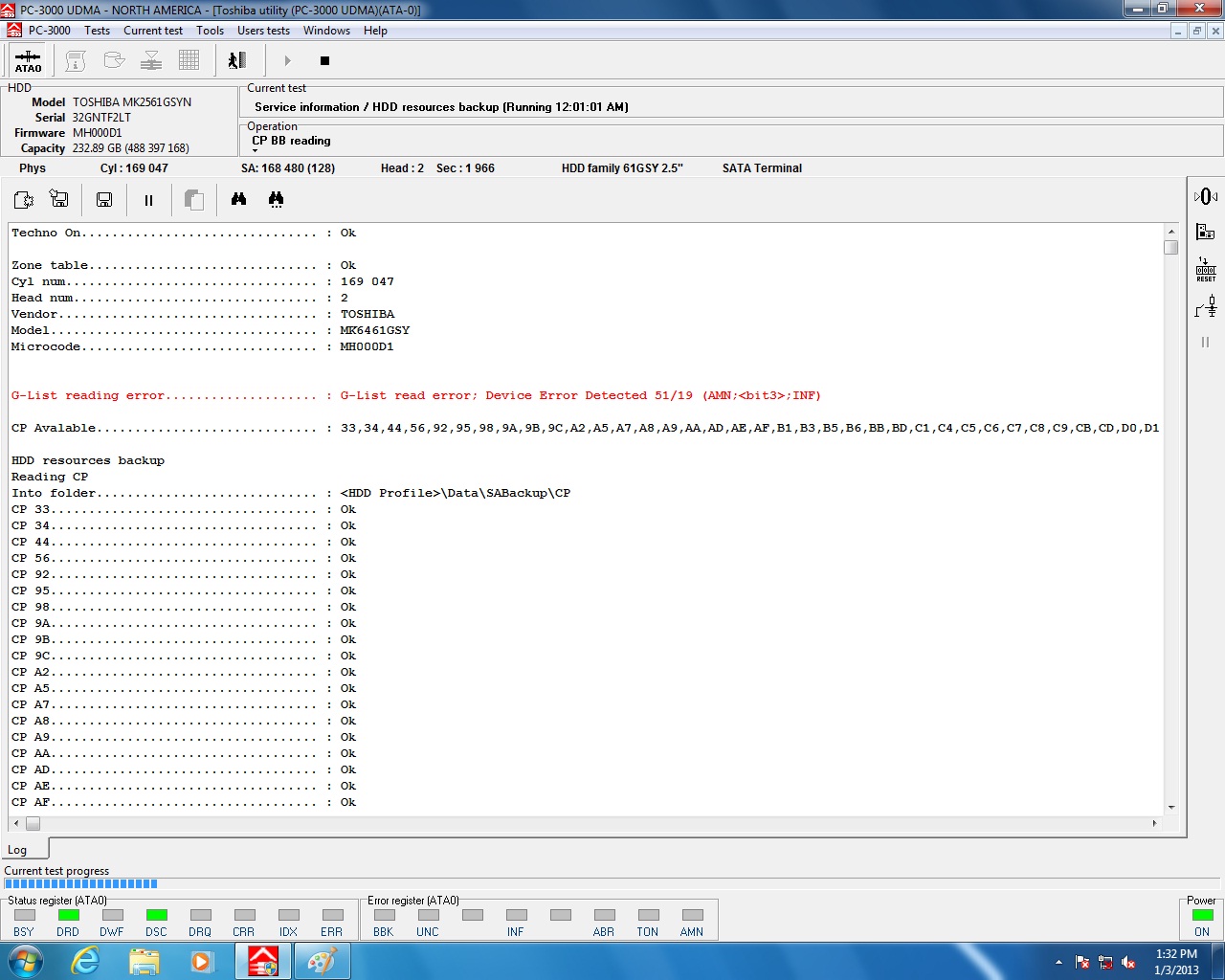

I have a 250gb Toshiba MK2561GSYN drive that comes ready with correct LBA, model, and serial number. No data can be accessed however. I am getting G-List reading error : Device error detected 51/19 (AMN;<bit3>;INF)

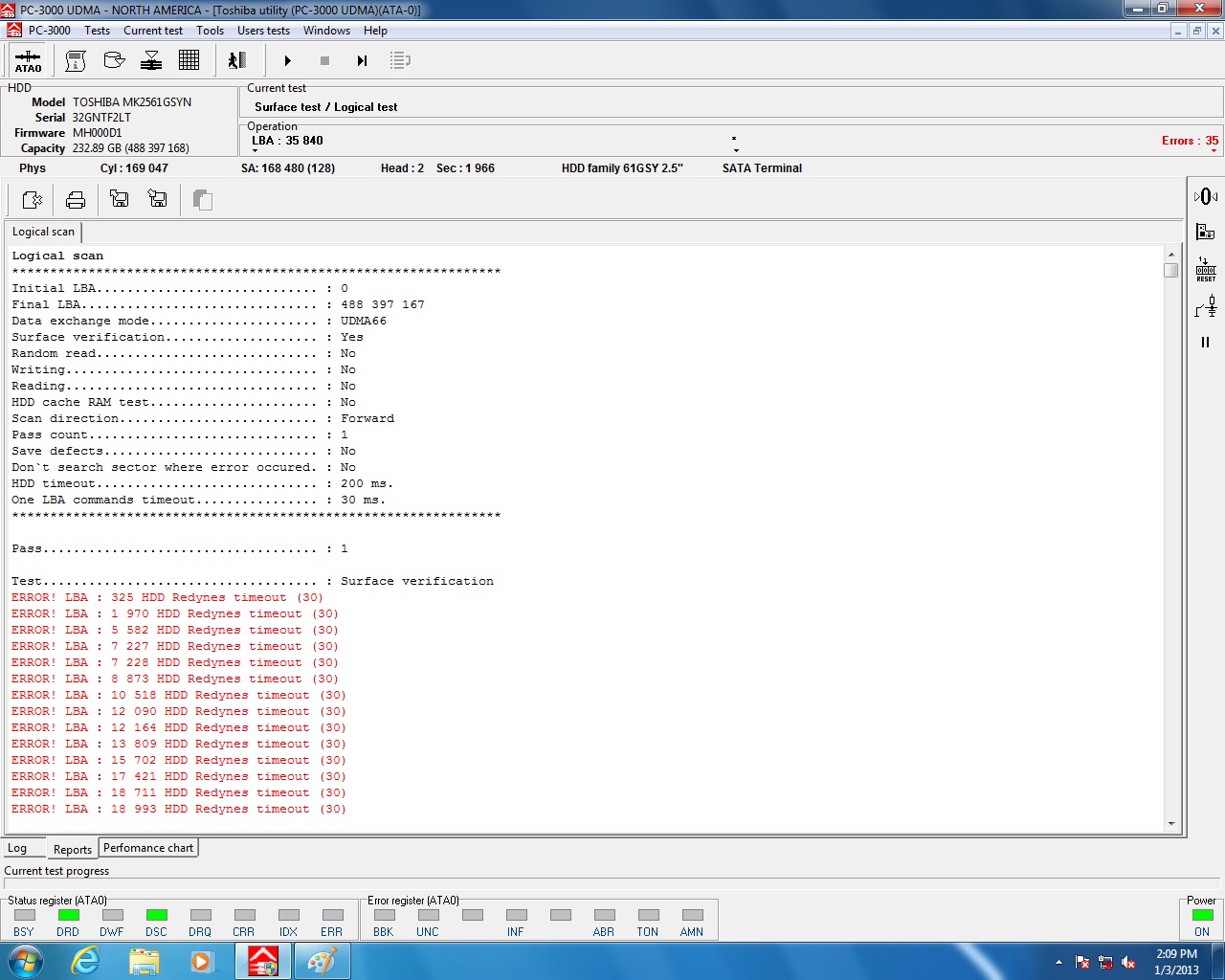

if i clear the g-list it just comes back and i get redyne timout 30 driving to do a logical verify test
Anyone know what the problem is or how to fix it?
I attached screenshots

Ah need the data extractor for this one.
